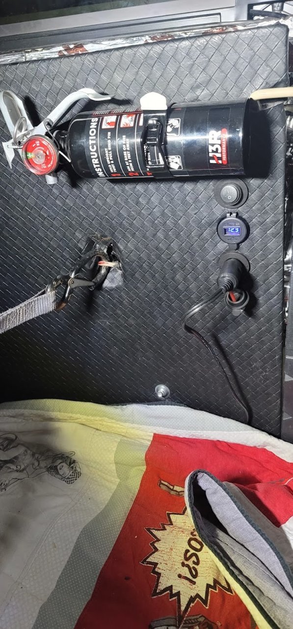

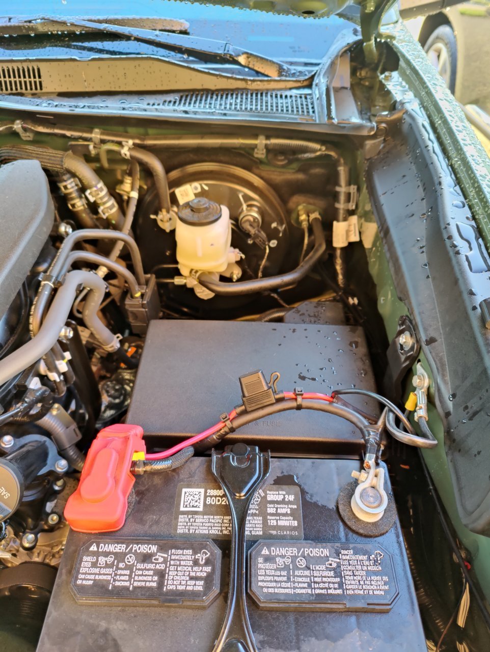

    Mine is connected to the aux battery (under the hood) with ~22 feet of 8 gauge zipwire, fused at both ends. One of these days I'm going to remove that idiotic usb plug and replace it with another cigarette lighter style socket.
    My 65 qt. SnoMaster (LP61) fridge has been running in the back of my truck, non-stop since March 2020, with zero issues.
    Btw, this is not MY mod... I copied it from another thread here on TW.

    I didn't add the voltmeter since it would be off a bit due to the length of the run but the cigarette adapter is perfect for my fridge. And I permanently mounted the anderson connector for my battery/inverter box. Super easy to do and very useful.

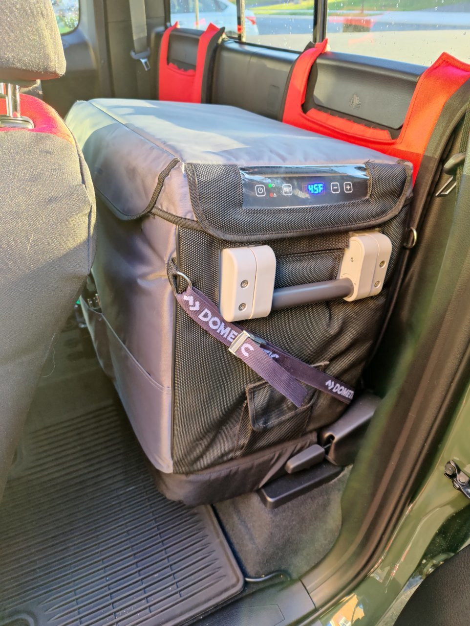

    is this why my dometic cfx75dzw will only run on emergency mode while on 12v power but will run perfectly fine when i run it off my inverter? i use a 12v 100amph renogy lifepo4 battery, then a this noico 12v hardwire plg https://www.amazon.com/NOCO-GC018-Adapter-Socket-Terminal/dp/B00G8WLW2Y and then the factory 12v dometic plug into that. the fridge also wont run 12v power unless on emergency mode when hooked up to a bluetti battery either.
    id rather not have to take it to a dometic service shop since theres only 1 in my area and their shop rate is $80/hr

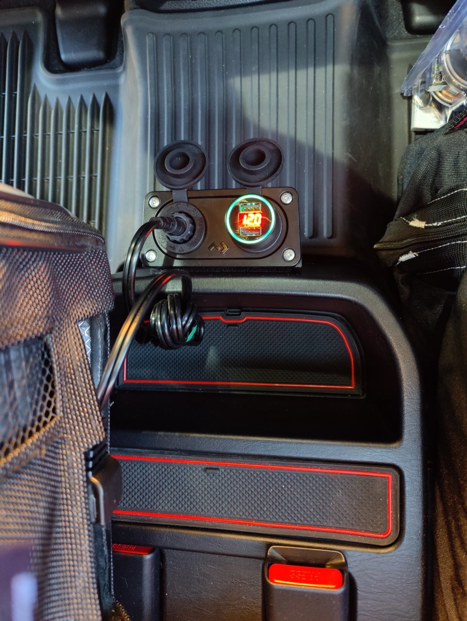

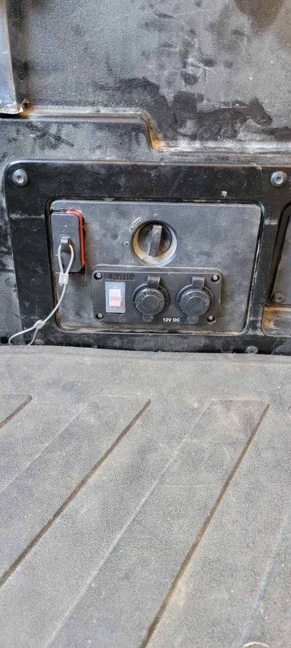

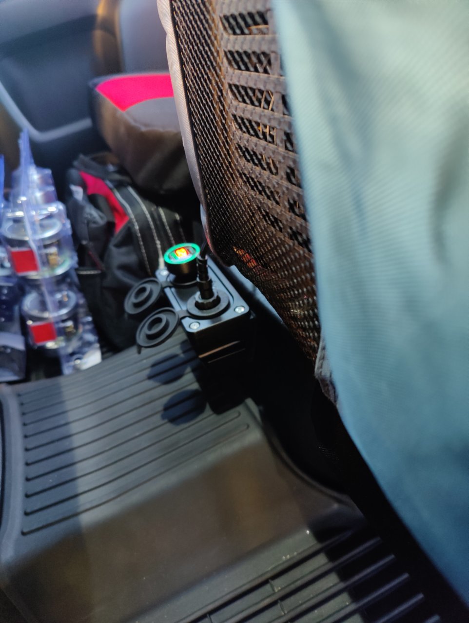

    Running off the lighter inside the cab is probably the best for your application. However, keep in mind that it is not always powered on the 3rd gens. Once you turn off the truck, the fridge will turn off too if plugged in there.
    If you want the fridge to remain on you'll have to run a dedicated line to it, which isn't difficult at all. Someone mentioned buying the NOCO kit. It's definitely an option, though it's a bit bulky and you'll also need to get the extension for it. A bigger concern personally is how to feed that into the cab without messing up the boot where the wire should go through.
    This is the setup I run with: https://smile.amazon.com/dp/B07WSXYCR6?_encoding=UTF8

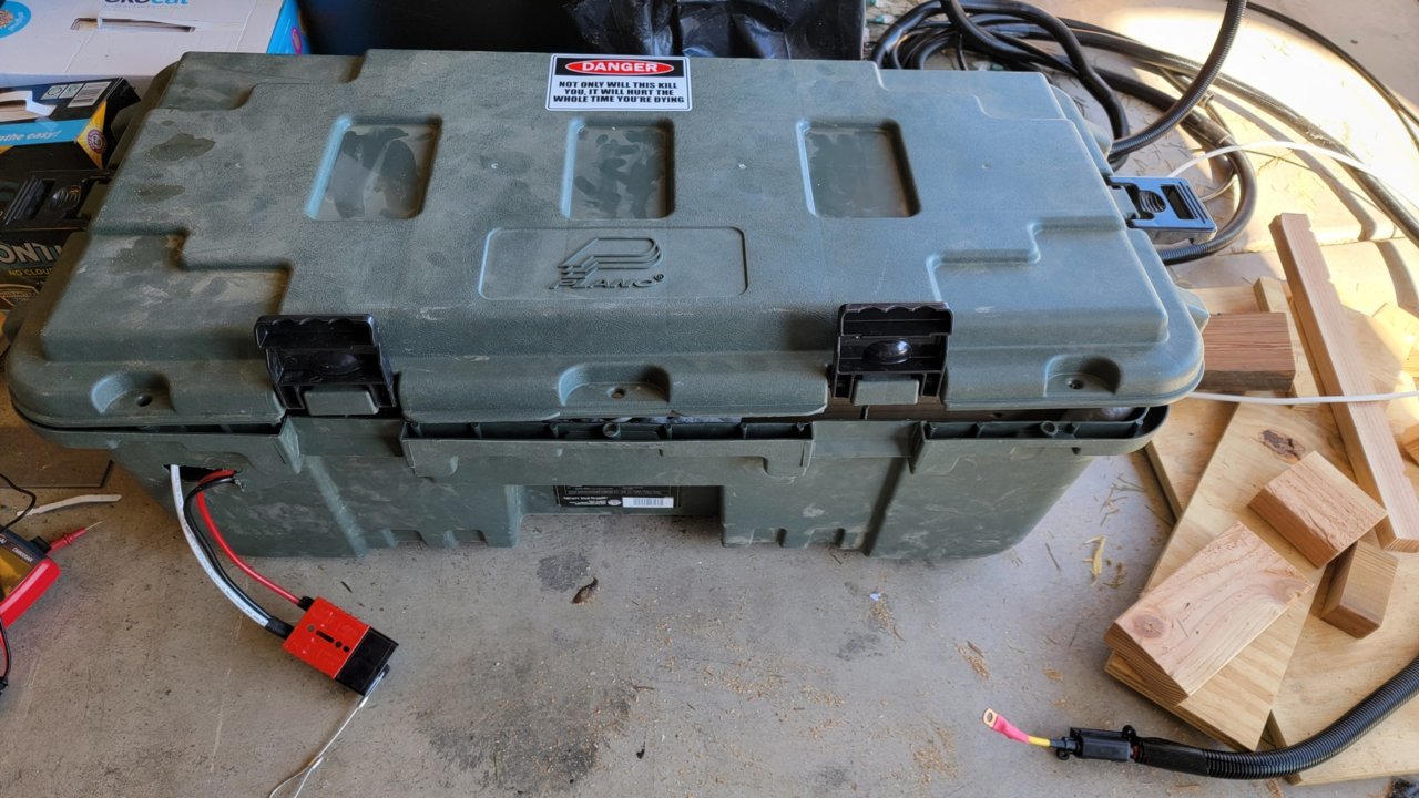

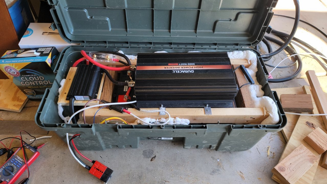

    It's an Ampere Time LiFePo4 battery (200aH 12v) connected to a duracell 3000watt inverter (modifed sine wave but it's been good enough). It's charged by a redarc bcdc1240 (from truck and/or solar). I used some wood and steel to hold it steady in the plano box, then sprayed expanding foam to keep it rigid and protect it while wheeling. The inverter alone was too big to be mounted practically anywhere in the truck. Now it lives in the garage unless I need it and I put it in the bed. I installed a 2AWG (overkill but limited on what size wire I could find) from the main battery to the little cubby in the bed. This way I can connect the truck power to the redarc charger and charge the lifepo battery according redarc's charging schedule. Another solid plus to redarc is the additional solar with green priority. I have a 200w panel I connect when we're camping. It's worked out really well and gives me the ability to power just about anything. I could even run my table saw for a LONG time with this if needed. The pics attached are the "dry fit test" and the wiring has been cleaned up / organized since. batterybox.jpg batterybox2.jpg

    This is the same Blue Sea panel I run my ARB off of. Flawless performance and has been subject to Utah snow, ice, rain, desert dust (SO MUCH dust) and vibration for several years now. Never an issue.

    For Ops goal if he’s running 16 feet he’d get a 1/2 volt drop with 12 awg at 84 watts starting current. He might hit his low voltage cutoff sooner than desired. 8 awg would be ideal. For the 50 amp load 2 awg is still a 3% drop so that’s a reasonable setup.
