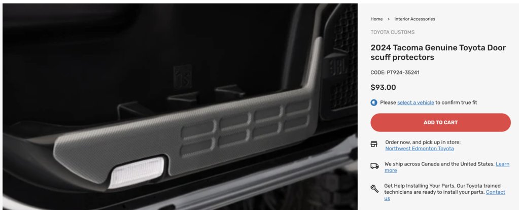

    if yall are having door panel rattle issues, check to see if you have the door scuff protectors. the one on the drivers side on my truck was loose. i'm sure they are only held on by double sided tape and mine just needed to be pressed hard for 30 seconds and it's solid now.
