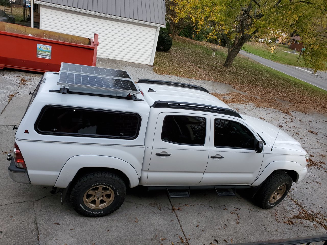

    ah hell, just drive around with solar panels and you won't need a jump starter. lol j/k

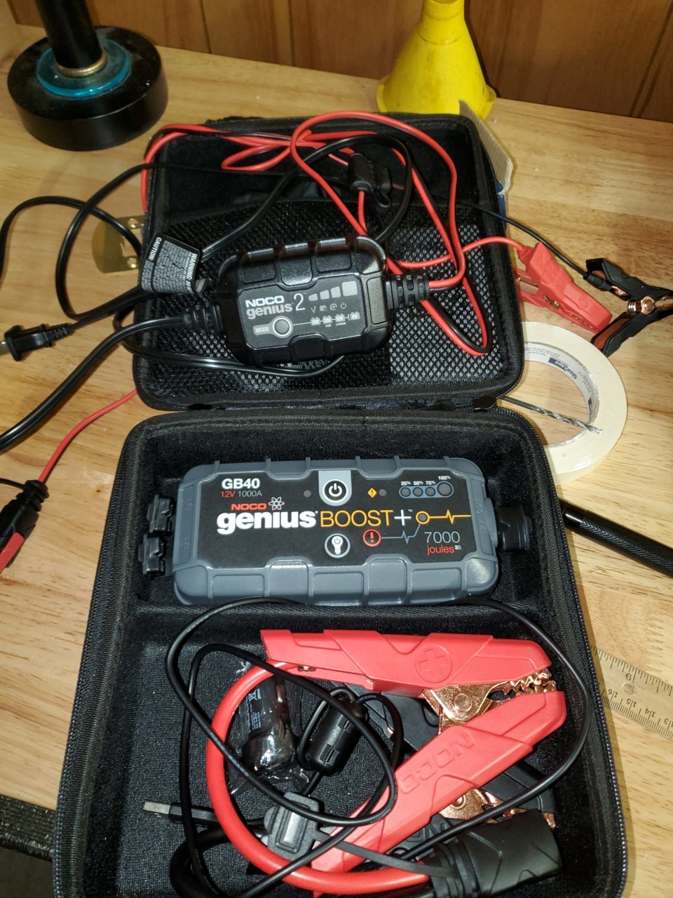

    I just recently bought a Noco GB40. I left it in the truck overnite when it was 35F, and in the morning I disconnected the battery and alternator, and started the truck solely with it. It started it, but barely- cranked slowly. But I started it twice with no issues and it only took an hour to recharge via USB. Bottom line is it's good, but if you have a V6 and live in a cold area, you may want to get one size up for ultimate insurance. I paid $70 for it on a price drop on Amazon. It fits easily under the driver's seat.
