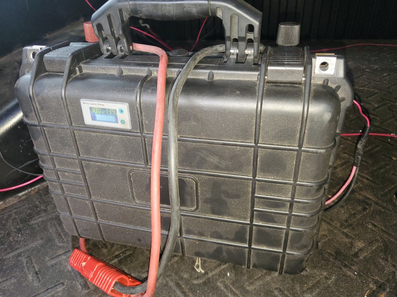

    I made a 110AH LiFePo4 a couple years ago. Also did a smaller 25ah version. The big one will run my edge star indefinitely with one 100w panel on the roof rack.

    Sweet power pack!
    Did you build a BMS (Battery management system) into it?
    If there is a build write-up, please post.

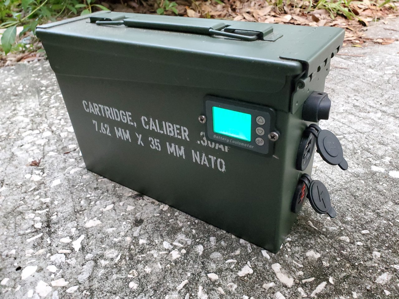

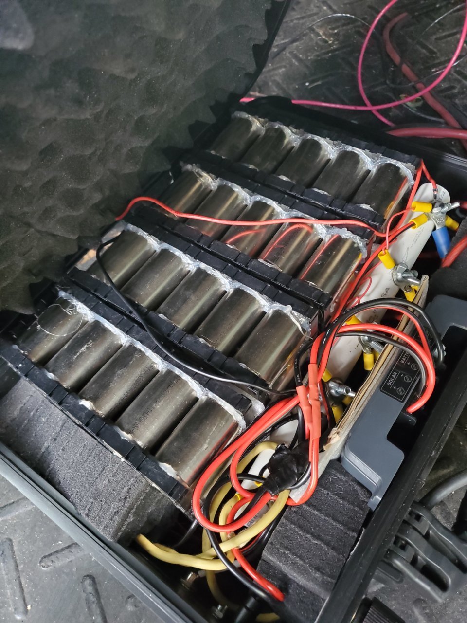

    Never written it up. It's 4S20P, 32650 cells that were bought in bulk. I have a battery spot welder, so making the cells is pretty simple. I used hot glue.
    It has a 100amp BMS (small wires), 60amp resettable circuit breaker. Renogy Wanderer solar charge controller. Box from harbor freight. I put large +/- lugs on it in with a big Anderson plug pigtail that connects to a panel in my bed.
    The ammo can pack is 4s5p 32650.
