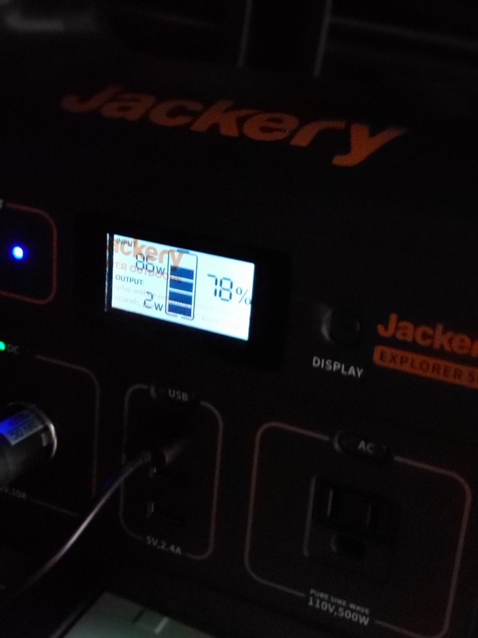

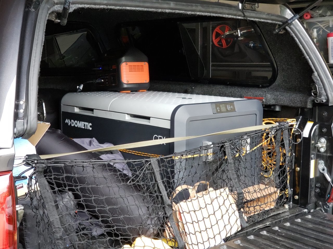

    The a couple of nights this past week got down in the mid 40F degrees and my fridge wasn't opened again past about 8PM. Sometime after about 10hrs of the fridge not needing to cycle through the night, the Jackery turned itself off due to very low draw like 1-2W. This obviously turns the fridge off as well. Around 8AM when I went to get our overnight oats and an apples for breakfast, I turned the fridge back on and temp only went up to 29 degrees from the last cycle it ran. All is good!
    These fridges usually swing about 2 degrees either way from setpoint. Set it for 28F and it will run until it feels it's thermometer reads 26F. Then stays off until it warms back up to 30F.

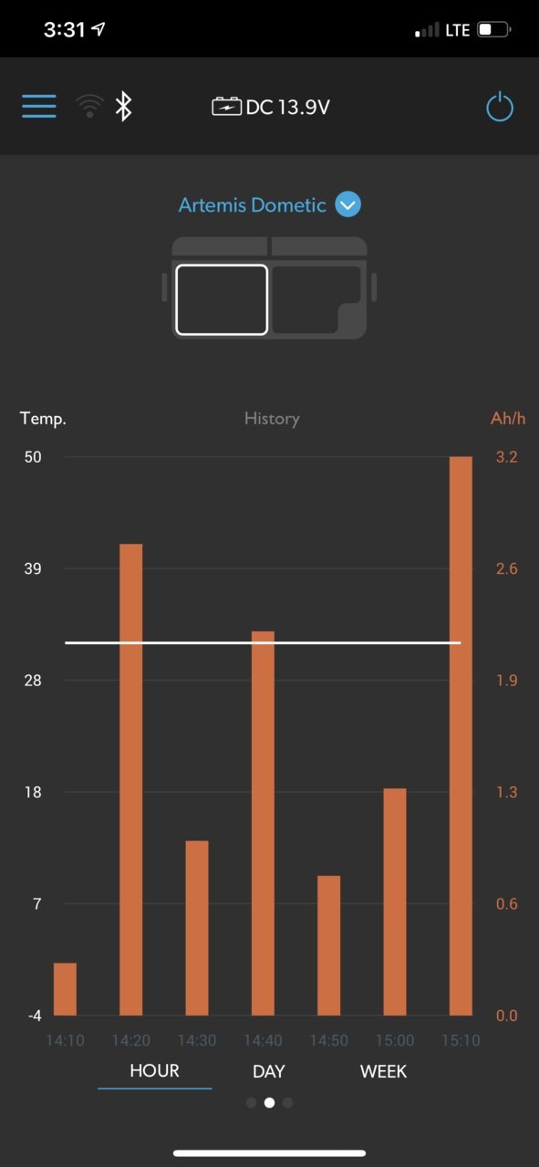

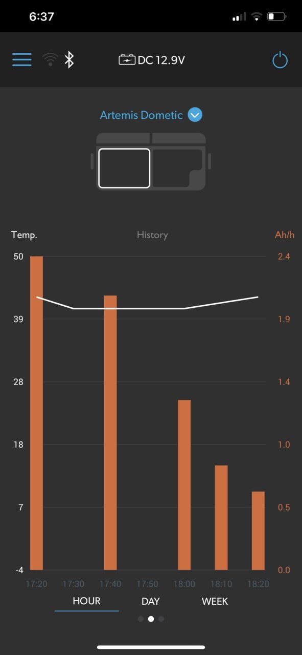

    So I use a Dometic CFX3 75dz for our camping trips (2 people). The big side is set to 41F and small side set to 5F (fridge and freezer). This is what the power consumption looked like over a couple hour period. Outside started around 60 degrees, and would get down into the mid 20’s. You’ll see obviously the colder it gets, the less power it draws. I power it off the 12V line I installed in the bed while driving, and then just switch over to my GoalZero 1500x. That combination without charging the power pack last 3 days, and the battery pack drained to about 80%. Would have no problem going over a week easily. Mind you, the fridge wasn’t packed very efficiently, and has a decent amount of unused space in it.

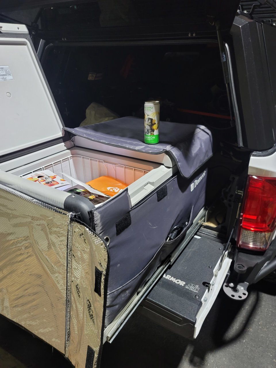

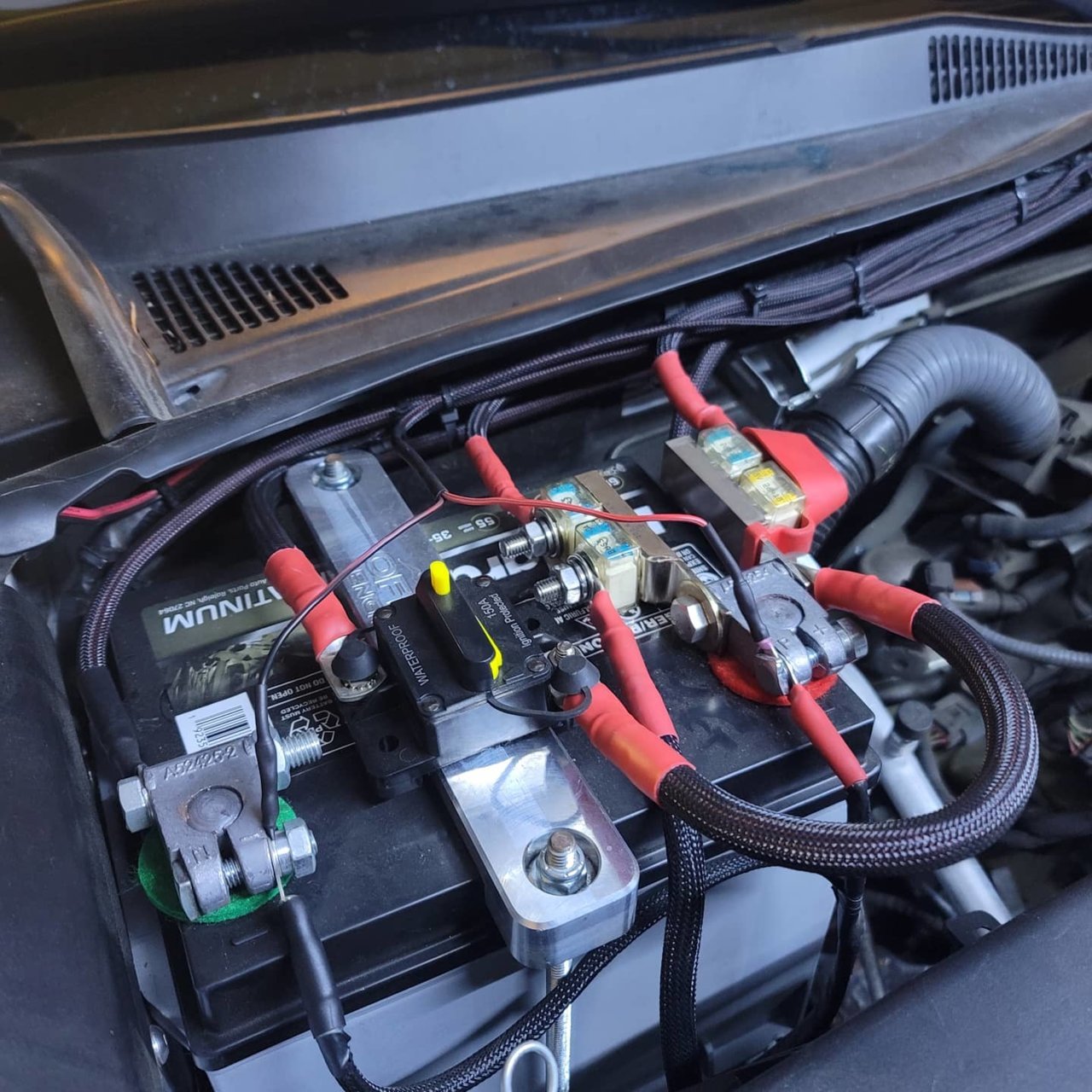

    Im running a dual battery system that powers my dometic 95qt fridge and a few other aftermarket items. So far so good, im loving this set up. Im using a redarc controller to control both batteries and also have a 100w solar panel connected.
    The second pic shows my 2nd battery. It powers my fridge, front and rear aux fuse panels, switch pro, air compressor, and the amps for my stereo system.
    I also cut the cigarette plug off the donetic power cable and attached a anderson plug. I have some usb plugs and anderson plug mounted in the small cubby.

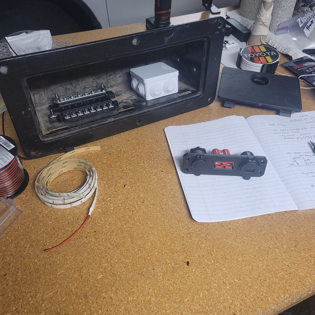

    Next time I go camping I should do a write up.
    My battery setup might be a little overkill with 3 x 100ah deep cycle Renogy Gel batteries but getting a 100ah for $250 compared to a Jackery 1000w with 1/2 that capacity for $1000 never really made sense to me. Sure the Jackery is Lithium and can take 1000s of charge cycles but I'm not camping months on end for years. I started with 1 and decided to add another and Amazon mistakingly sent me 2 and you can't return batteries to Amazon.
    :bananadance:
    I'm running a Dometic CFX 75DZW ( previous model ) and also use the battery bank, which sits in the bed behind the cab ran in parallel, for charging phones, running led lights, etc.. I got away from bringing my inverter since I don't really need 110v and when I do, say blowing up tubes, I use the inverter in the truck.
    Like others I start out with fully charged batteries and a cold fridge/freezer and fully stocked at least the night before we pull out. I plug the Dometic into the inverter while I'm driving to the campsite, if I can remember to push the button every time I start the truck. I also tend to run the fridge zone a tad bit cooler when I'm driving to the site and put them back to 0/32 when I arrive. If all of the freezer items have been consumed I'll put freezer back to fridge temps. My camping trips are normally 3 days and I'm not for sure how long my batteries would really go without any charge but 3 days is no sweat. I've been thinking about adding a DC to DC charger but I really don't need it unless I want to start doing longer trips. If I were going on longer trips I would likely add my solar panel into the mix that is currently sitting idle in my garage.
    If you're running off your main battery you definitely want to set the battery drain safeguard setting on the fridge and I'd also recommend a portable jump box. I can't imagine running off my main unless I was driving hours every day and only running in fridge mode. Maybe it's different in cooler climates, I'm in N. Ga and generally camp there or N. Carolina.
