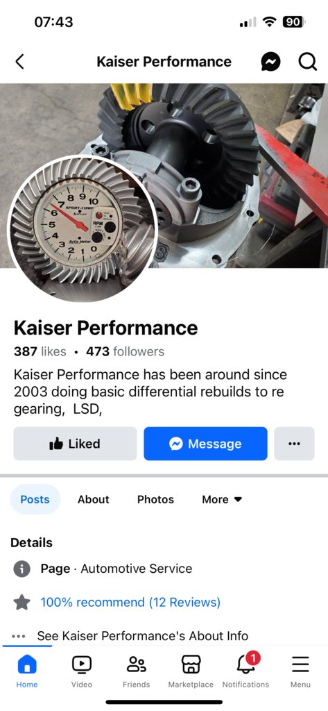

    Has anyone heard of Kaiser Performance? It’s located in Beaverton (per their contact info) and they specialize in differential rebuilds and gearing. Forgot how I came across it but haven’t seen any posts after a quick tacomaworld search.

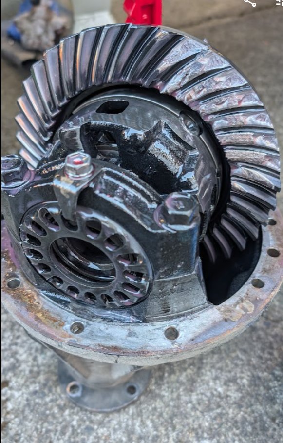

    Whelp I'm in the market again, broke my rear gears yesterday. Fortunately just around the corner from my house and she was still rollin so I just crunched it to the driveway in 4wd. Sounds like I lost a few teeth off the ring gear. Frankly I'm surprised they lasted this long considering the circumstances.(8/2021 -> 1/2025) Weather lookin pretty shite so it can just sit in the driveway for now. Evaluating if I should just pull the trigger on the diamond now or slap a ECGS set in temporarily to get rollin.

    I Elocker swapped my Sport. I broke 3 ECGS 8.0 3rds before I swapped back in my Sport 8.4 with an ARB. Yes I know the 8.4 is really an 8.0 but I think you catch my drift. Not sure what rear axle is in your FJ. I haven’t had any problems with the ARB 8.4 combo. The ARB has 4 spider gears to spread the load. The 8.4” has the girdles to stop pinion deflection. In my opinion the Elocker is a weak ass diff.

    FJ is just the e-locker 8". Tbh I'd probably be fine with an 8.2", but I want a real LSD more than anything and you only get them on the big-boiz. I'm stuck re-gearing either way, I'll probably use this.. opportunity? to drop back down to 4.56 as well..
