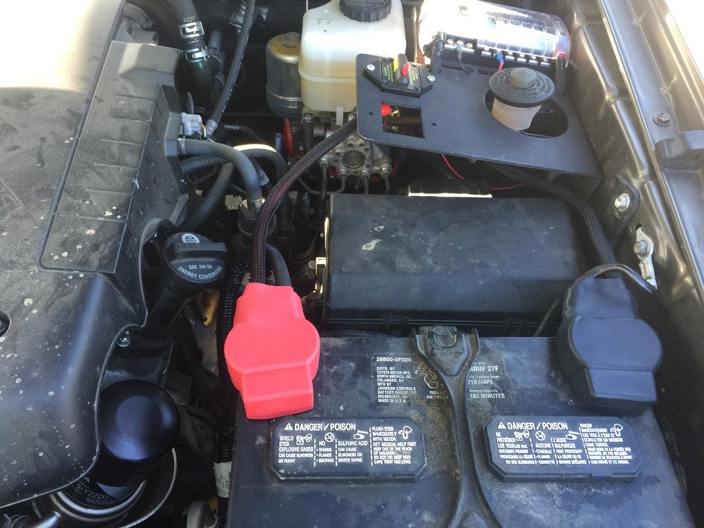

    Sorry for the delay, here are the photos.
    This is just an overview of the setup I did, the actual blue sea panel is in the back.

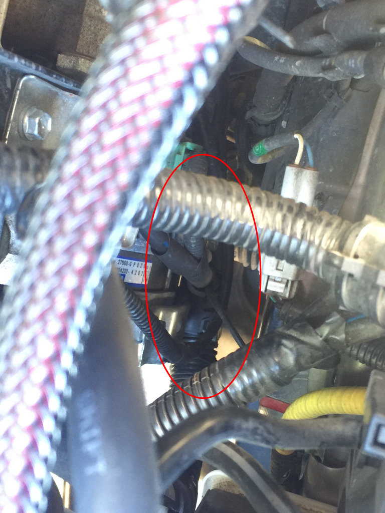

    This one shows the first plastic clip that holds the wiring loom in place. You can use a flathead to get it off the mount and then again on the harness itself to unlock it so you can reuse it later.
    Better photo of the same clip.

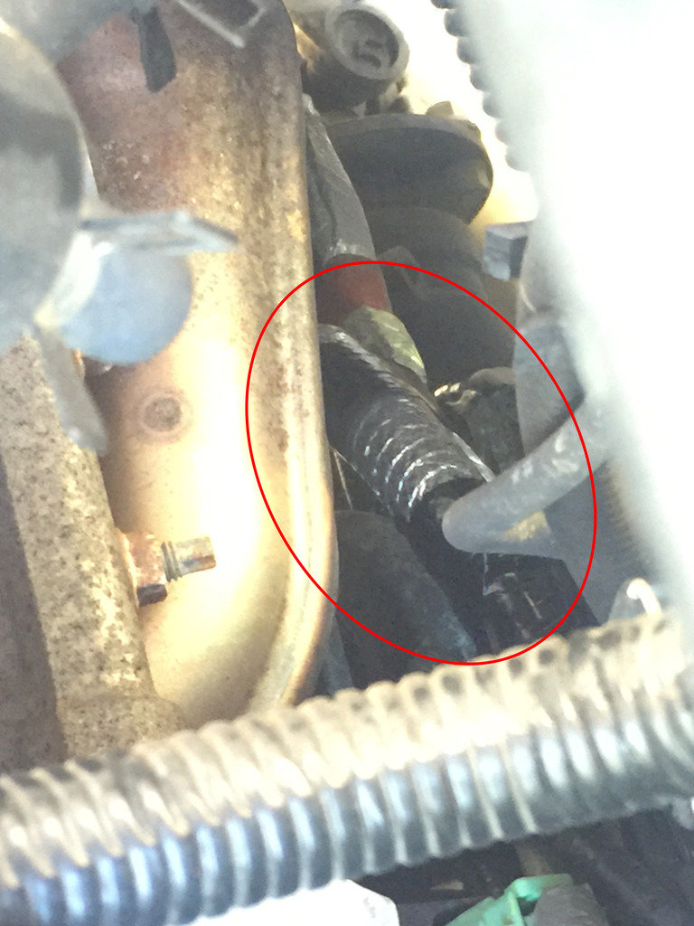

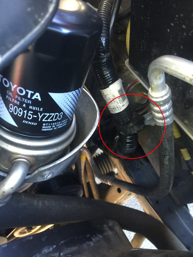

    This is a really hard to see photo but the thing is in an awful spot. It's directly behind the housing for the strut on the driver's side. I jacked it up and took the drivers side front tire off as well as the splash guard stuff. That helped a lot but it was still a pain. It's attached to its mount in two places, then there are two or 3 tabs to unlock the actual harness itself. A lot of different wiring all comes together here so be careful with this one.

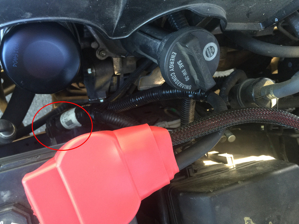

    Lastly there is this section of wire that has heat shielding on it to protect it from the exhaust manifolds. you can peel this stuff off and reuse it. The cable connects to the starter with a terminal but I cut it off and used my own simple 3/8" eye terminal and it's working fine.
    You can go to a Napa and they will build the actual wire for you, soldering the terminals on and heat shrinking it and everything. Or you can do it yourself. 3/8" eye lugs with work fine. I got some solder and flux little pucks and you can just set them in the lug upside down, heat it up with a torch and then just stick the wire straight down into your little puddle of solder and that stuff won't go anywhere. Another thing to note is that it appears like the stock wiring is 2 gauge but the insulation was sort of smaller than standard 2 gauge. So you'll want at least 2 gauge but the wire will be bigger than stock and you might have to wrestle with it to get it all back into the stock harnesses and attachment points. I got 36 inches of cable and that left what you see in the first photo. Some slack but nothing too much. If you have any questions let me know.
