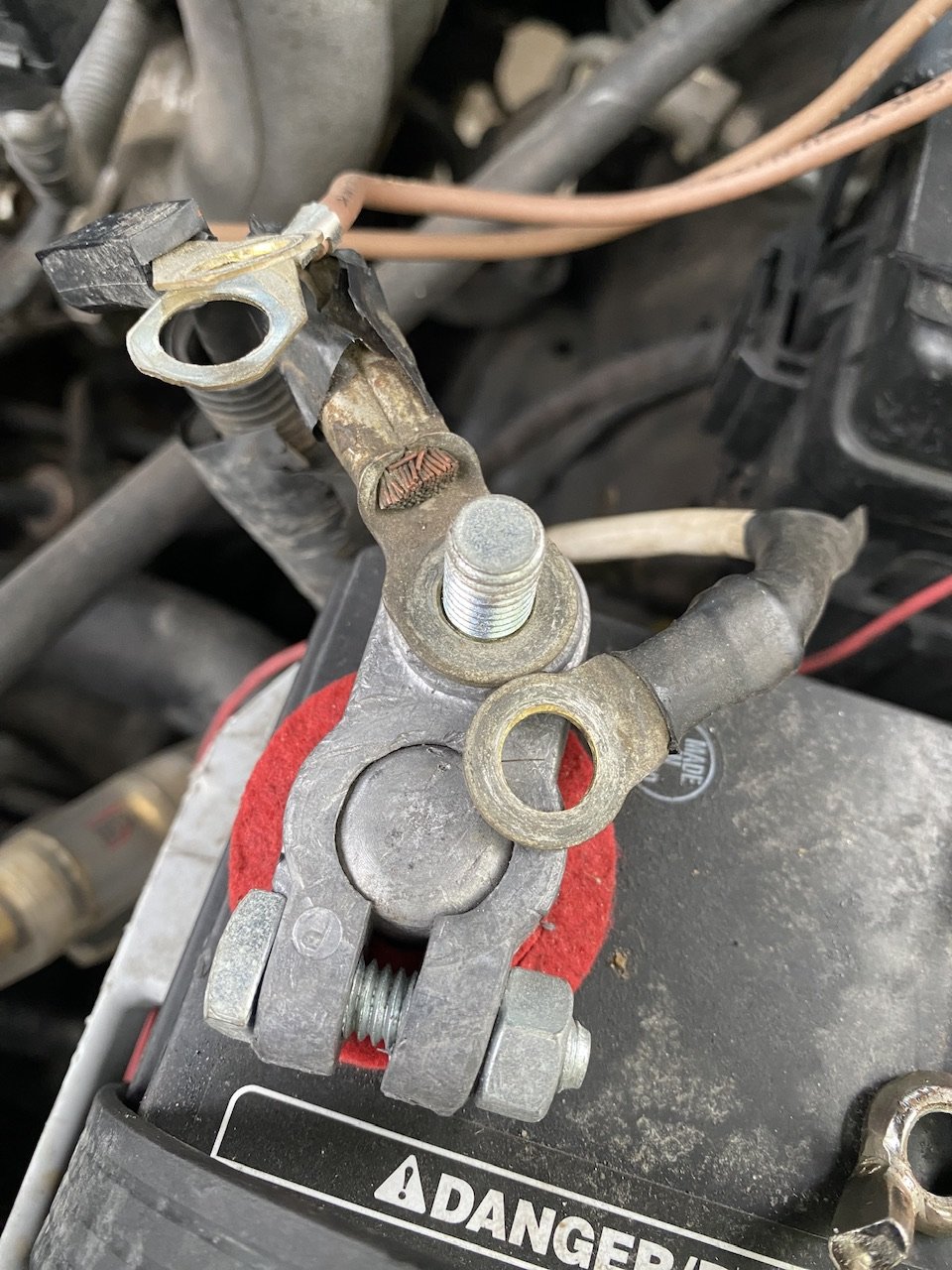

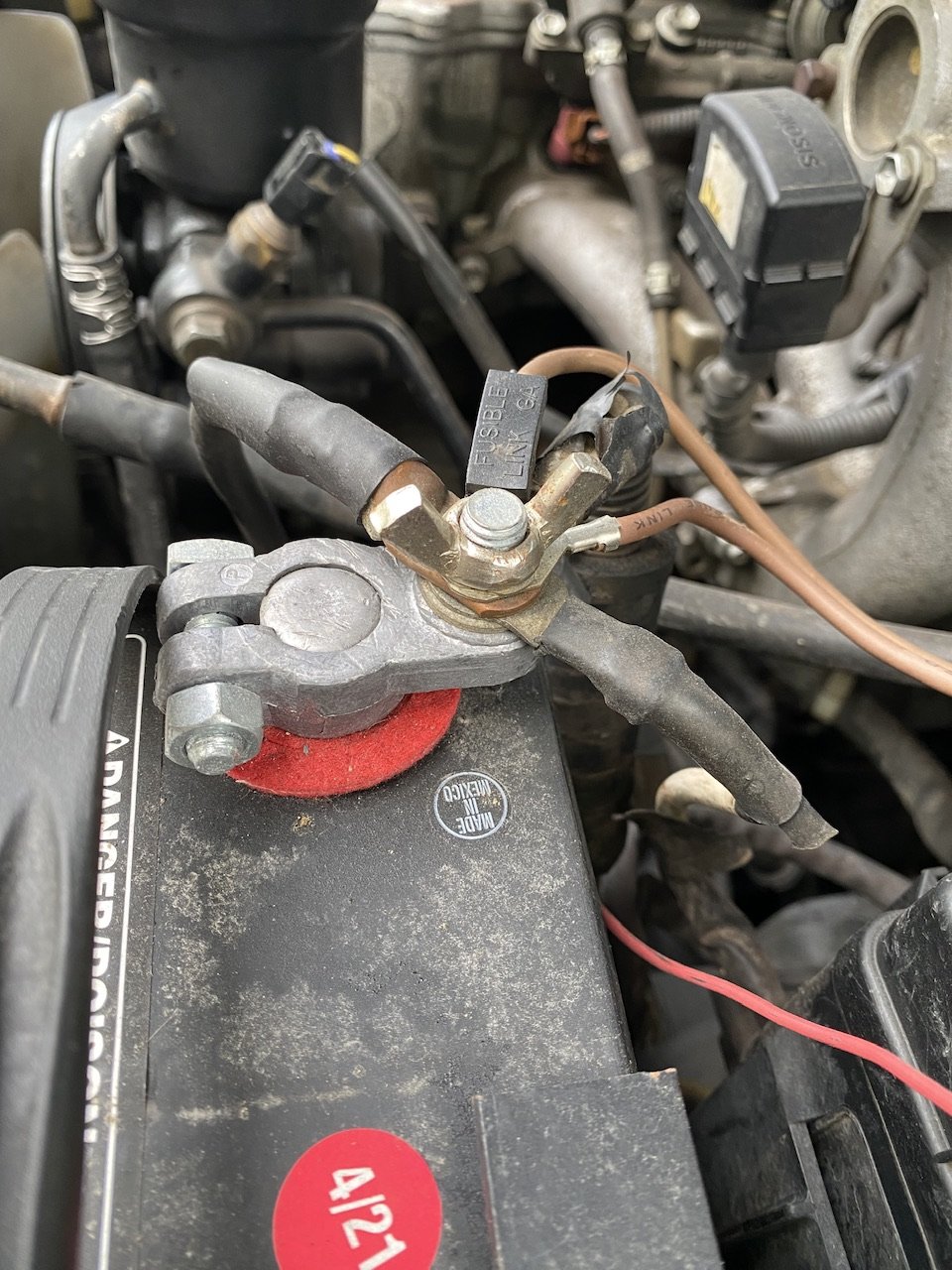

    Hi all, recently the battery warning light has come on occasionally on my 1996 5ZE-FE rig. I've yet to diagnose it other than test the battery itself, which is newer and fine. One possible culprit is the positive battery terminal, which is hella old and rusty.
    In any case, I'd like to replace the terminal because of its condition. Any recommendations of a replacement model? The positive cable is quite taut, so I'm concerned that once I trim it and attach the new terminal, it won't quite reach the positive battery post. Thanks.

    I modified the existing wire lug to fit onto one of these guys. Done this on 2 different vehicles and it’s never been an issue.

    Might not hurt to upgrade the cables now as well.
    i have been using Marine Grade terminals and Making my own Cables for years.
    Have you checked your Alternator output while the engine is running?
