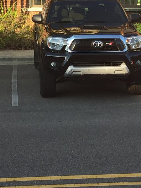

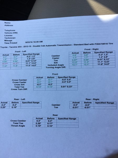

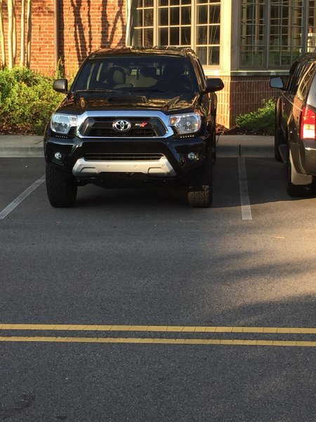

    Bilstein 5100s at 1.75 setting. Alignment done after install. I did not get the numbers after the install. I noticed about a month later the front wheels had a slight \ / look to them. Truck rides great. No problems. Don't like the cambered look though. Just had the alignment checked today and these are the numbers. I didn't get them to change it because they said it was within spec. Any suggestions? Should I take it somewhere else?IMG_0238.jpg IMG_0229.jpg IMG_0227.jpg Probably hard to tell from the pics but there is slight positive camber

    It's normal! Mine's the same way. Helps with wandering around the road I believe.

    All 3 of my Tacos, 2 base 2wd trucks and my current TRD PreRunner had/have a bit of positive camber straight out of the box.

    Ok, so do those numbers look ok though?

    Does it drive good? That's all that matters.
    Numbers on paper have no effect on driveability.

    Yeah, those look just fine.

    It doesn't because your tires aren't wearing while parked, and your tires aren't in that position every time you drive.
    0 camber will cause tire wear like you mentioned.
