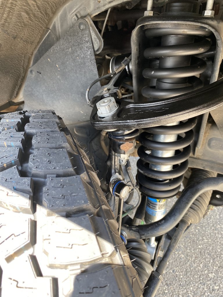

    I have SPC UCA’s on a 2.5” lift. With the SPC’s you can have any camber you want as long as you don’t rub the tire on the UCA. It’s completely adjustable. I’m set at -0.4 L and -0.5 R right now. The more negative camber you go the closer the top of the inner tire gets to your UCA
