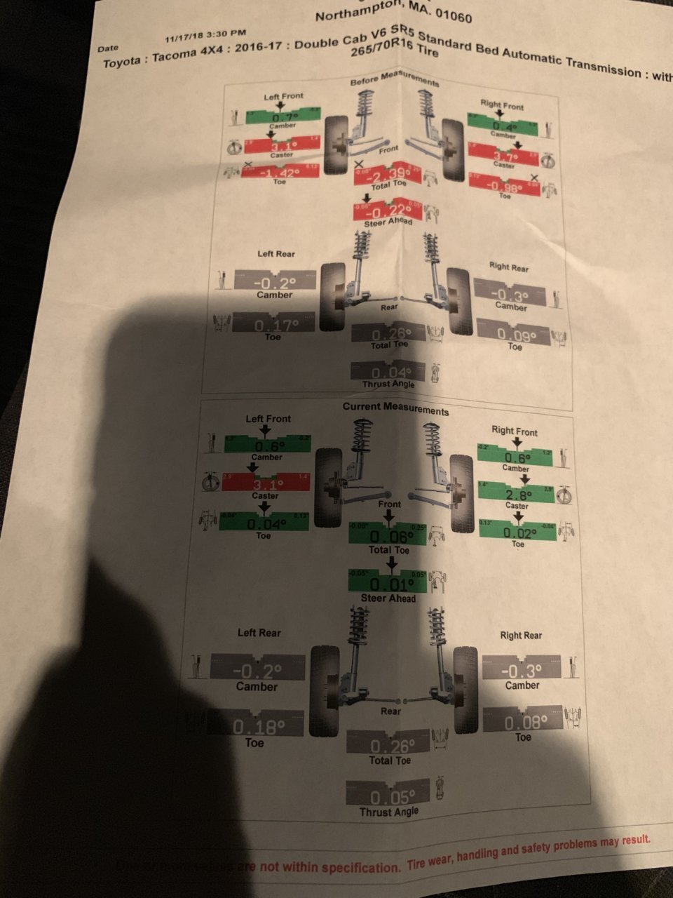

  12. Nov 27, 2018 at 4:01 PM
    #72
    ejewels
    ejewels Well-Known Member
    Dec 13, 2017
    #238387
    1,669
    CT
    2018 MGM TRD OR 4x4 DCSB
    6112/5160/Dakars/Pro Tacoma Wheels
    Sorry for the shadow but here is my alignment.
  13. Nov 27, 2018 at 4:16 PM
    #73
    splitbolt
    splitbolt Voodoo Witch Doctor
    Mar 7, 2010
    #32761
    7,858
    NW Arkansas
    2016 TRD OFFROAD DCSB MGM
    Okay...
    Rear thrust looks good; one of the best I've seen.
    The higher caster on the passenger side will toe-in more under load, causing a pull to the passenger side. Toe is favoring the passenger side a little too. Add some road crown....I'm guessing your steering is clocked left. Is this what your experiencing?
    If anything they should have the caster numbers swapped left to right to compensate for road crown.
  14. Nov 27, 2018 at 4:38 PM
    #74
    ejewels
    Dec 13, 2017
    #238387
    1,669
    CT
    Thanks.
    The truck seems to track very straight. Not pulling left at all. The steering wheel is slightly tilted right when driving straight, but otherwise the truck tracks straight (if on a straight road of course with hardly any road crown). I guess my next alignment I’ll tell them to try and make caster and toe more equal side to side?
  15. Nov 27, 2018 at 5:22 PM
    #75
    splitbolt
    Mar 7, 2010
    #32761
    7,858
    NW Arkansas
    Your alignment should have you clocked left.
    If it's clocked to the right then it is the centering of the steering wheel that is off.
  16. Nov 27, 2018 at 5:24 PM
    #76
    ejewels
    Dec 13, 2017
    #238387
    1,669
    CT
    Ok thanks. So sounds like the tech just was lazy or didn’t have good eyes. And the truck drives straight so I guess I’m good? Nothing seems to be going left but I haven’t really tried it.
  17. Nov 27, 2018 at 5:30 PM
    #77
    Diablo169
    Diablo169 ROKRAPR
    Mar 12, 2016
    #181079
    2,908
    Max
    Santa Cruz, CA
    99’ Bro-Coma’s Revenge 3RZ 345k+
    Stock
    You want slightly more caster on the passenger side to correct for road crown. I prefer 0 camber and .02 toe, at least that's what I ask for and if it's close I'm happy.
  18. Nov 27, 2018 at 5:35 PM
    #78
    splitbolt
    Mar 7, 2010
    #32761
    7,858
    NW Arkansas
    GTG.
    I wouldn't be so quick to blame the tech.
    As you mentioned earlier, Tacoma spec has a lot of freeplay in the steering; 30mm.
    Guess they could have caught during a test drive, though...
    ejewels[QUOTED] likes this.
