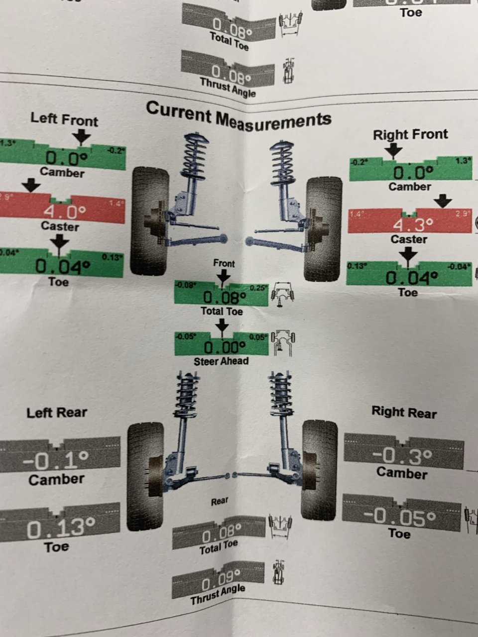

    Before I lifted my OR did not notice any positive chamber. Once I lifted I did. Installed SPC’s once lifted these trucks need custom alignments not factory spec alignments IMO. E3C55DDC-6667-45B0-96DC-AD4D1000660B.jpg

    That is a solid alignment. I am not a fan of the lower caster spec that Toyota has. 3-4 degrees is better in terms of tracking. I'm guessing the Toyota engineers liked the lower caster spec because it puts less stress on your suspension components.
