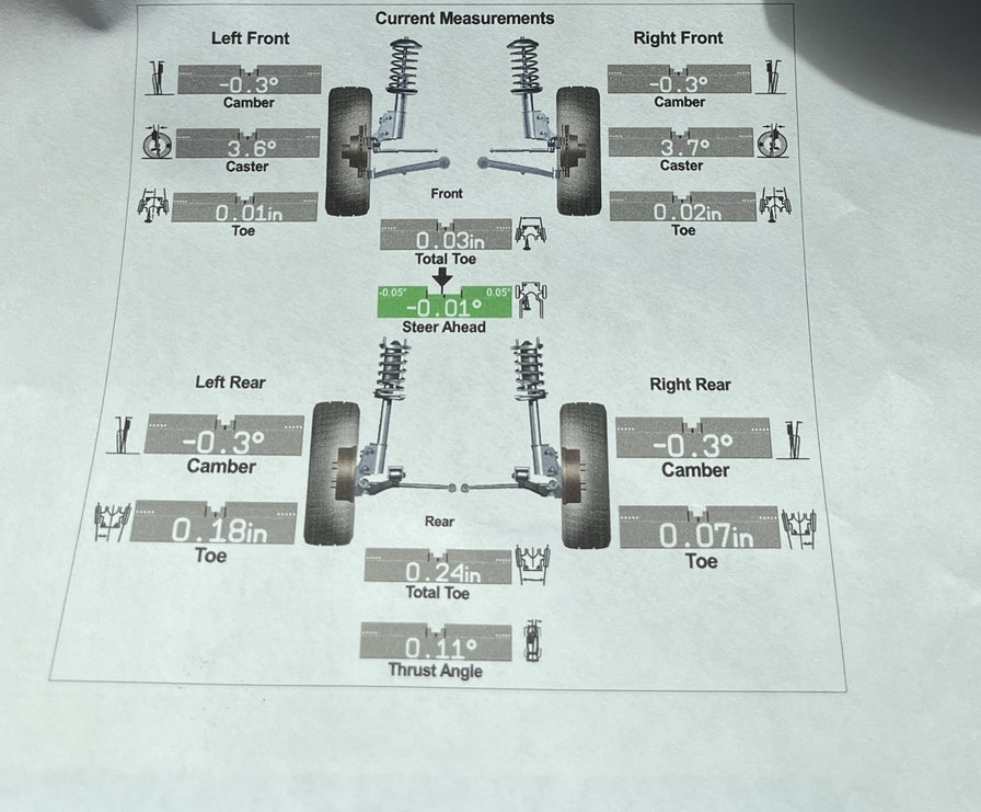

    Ran mine at ~.4* like Toyota specs for about 15k miles. Poor outer edge wear was the result. Set it back to 0* and honestly the truck drives better and should hopefully wear tires better.

    154
