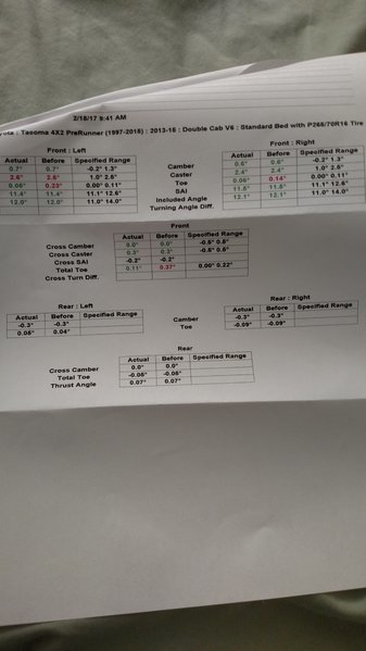

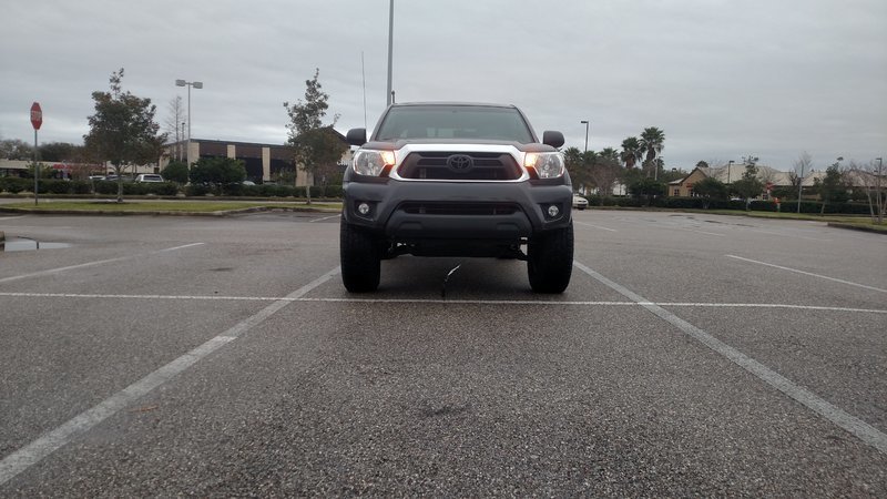

    Just installed Toyo open country AT2 285/70/17 with adjustable Bilstein set at 2.25 to help the tires fit. I am now noticing a positive camber stance in the front ( \---/ ) with more tread wear on the outside ( main issue). An alignment was done after install. Truck rides fine doesn't really pull to either side. I have been back twice for realignment and each place tells me my alignment is dead on to specs...Now that I ride a bit higher wouldn't I be out of range of stock specs? What should I do or say at this point? Aftermarket UCAs? Specific numbers to tell them?

    Welcome to the site. I seriously doubt your alignment is in spec with a 2.5 lift. Got the print out?

    I know each truck is different but hard to believe those numbers are right being at stock measurements with 2.5" of lift. Just visually looking at your truck, you have positive camber greater than what your print out states.
    From my experience, it's hard to get +2 on caster at 1.75-2" of lift already.
    Most regular alignment places don't want to spend too much time dialing in an alignment. For the most part, most of the alignments they do only require toe only adjustment.

    #1 You got the toe&go alignment
    #2 I have a hard time believing the truck I'm seeing with back to the future wheels only has ~.6° of positive camber. Maybe my eyes are totally fucked or the picture is making the angles look much worse for some reason. o_O
    #3 This is a perfect example of why being "within spec" doesn't mean shit.
    #4 You probably don't NEED upper control arms. You just need a competent alignment tech. You MIGHT lose some caster during the process.

    2. "Back to the future wheels" lmao damn man i don't even know how to take that but either way it's funny. The photos may be exaggerating the angle but it is still slightly noticable in person.

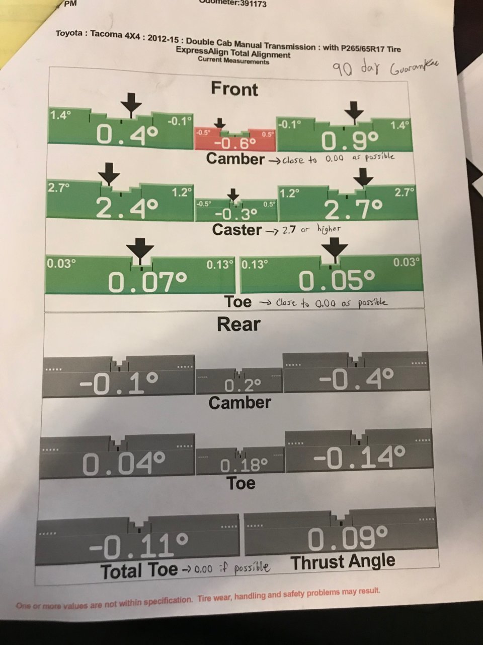

    All the same issues here. 2 alignments at toyota, 1 at 4wp.
    I have the SPC light racing UCA's installed, but I don't think they've ever adjusted anything from the UCA.
    I think when I go back in I'll tell them to put the camber between -.5 to see if that does it.

    +1 for going somewhere with a competent tech. When I did my lift I replaced UCA’s and everything, and my truck looked almost identical to yours after I took it in for alignment. Everything was “in spec” and the tech claimed that was “the best he was able to do”. Took it to a 4wd shop in town and they spent all of 5 minutes unfucking the other guys work. No issues since, no positive camber.

    Put -0.5 camber on both sides, that will make the wheels look more vertical.
    When I had 0 camber, the wheels looked positive cambered. I’m actually getting more even tire wear with -0.5 camber.
