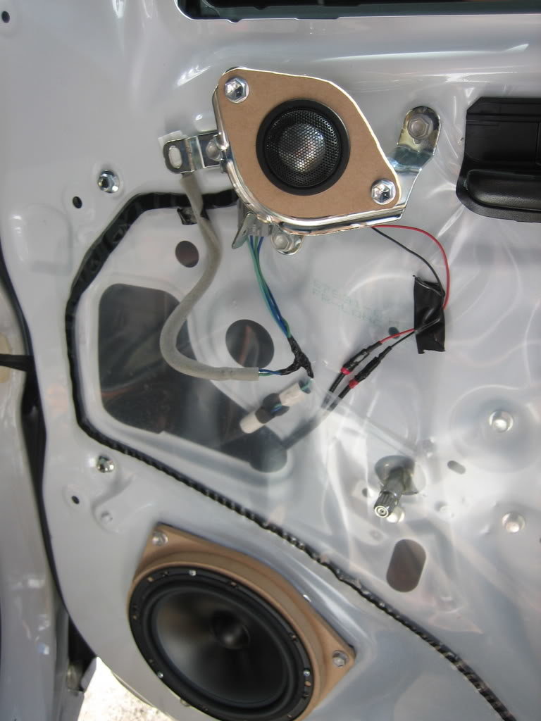

    2007 DC. front speaker wiring. which color is positive and which is negative on the factory speaker harness?

    The colors are different on each door. One post I found lists this (LF=left front, LR = left rear):
    LF (+) pink
    LF (-) violet
    RF (+) blue
    RF (-) light green
    LR (+) black
    LR (-) yellow
    RR (+) red
    RR (-) white
    You can double-check it in the FSM:

    Thats a negative. I just swapped speakers in the front last month and there was different colors on every wire, at each door.

    don't the negative ones have black tracers tho?
    idk it was a year ago when i changed mine out...could be wrong
