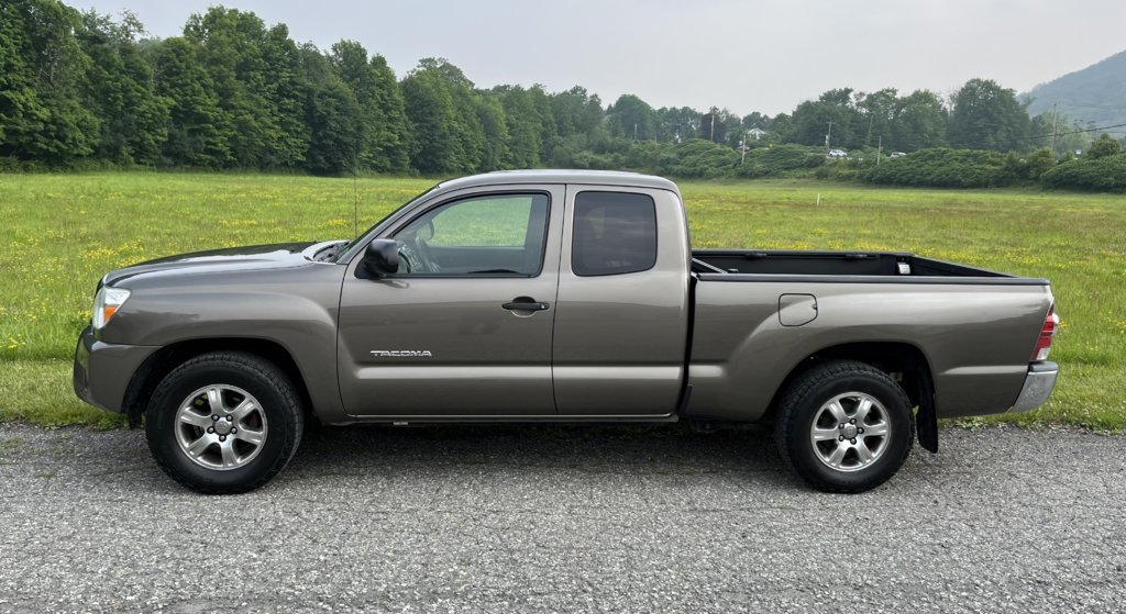

    No opinion on adapters. I found it easier to use wheels with a matching pattern.
    There are plenty of better looking wheels with the proper lug pattern. Wheels from Highlanders, RAV4s, Siennas, earlier Camrys, some Jeeps and Mustangs will fit.
    Search the 5 lug part of this forum for wheel swaps others have done.
