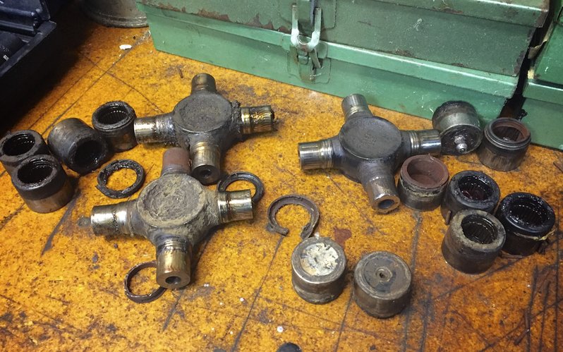

    @MrGrimm thanks for the info. Did you need any special tools to get the u-joints on and off? I take it you replaced all 3? I'll get under there in a bit and see if I can notice anything wrong with the u-joints. I suppose I could try greasing them up a bit before spending the cash on new ones. I forget, do all 3 have zerk fittings?

    Yeah it's tough with all the other rattles & shit, do your best & hopefully it'll sound like loose bailing wire flying around, not to put you on the spot but do you know to check Ujoints for play ?

    @4WD no lol, shake them? It def. doesn't sound like wire spinning around the drive shaft. I can't hear it at higher speeds. I don't vibration or anything

    I don't know where you live in sd but it'd take 5-10 mins. for me to check & show you so you'd know in the future...

    I live in escondido right at the 15/78 split. I just got back from taking some video. I'm going to watch and listen to see if I can hear it. I also took some pics of all the u-joints
