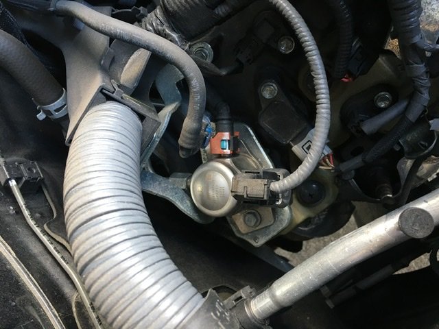

    If I’m correct the high pressure pump is in or near the tank. This sound is obviously coming from the passenger side cat under load. Outside of the truck with someone else flooring it you can hear it scream. Like it is bottled up but enough exhaust pressure shoved in will force a hole and make it through.

    High pressure fuel pump is in the engine.

    Good to know! Maybe that is the cause then. I look forward to finding out.

    Ah. This thing. I’ll play with it.

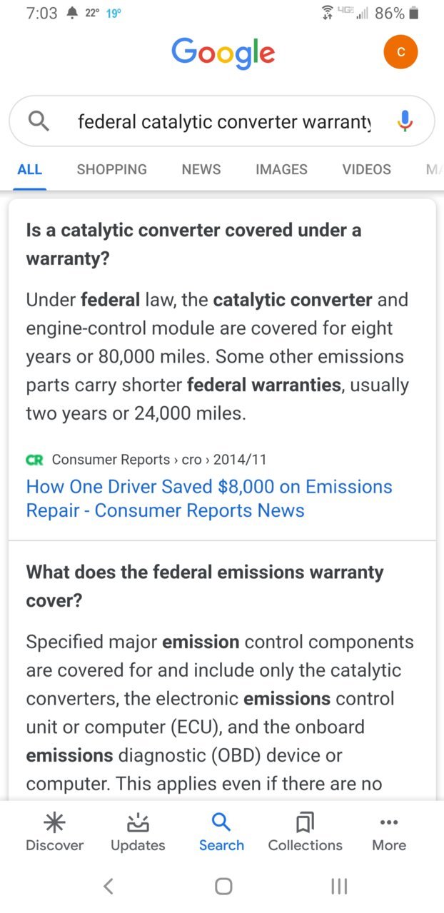

    Should it be the cat they're under warranty till 80k

    I believe by government standards it’s 8 years/100k? Used to be on ‘merican brands anyway
