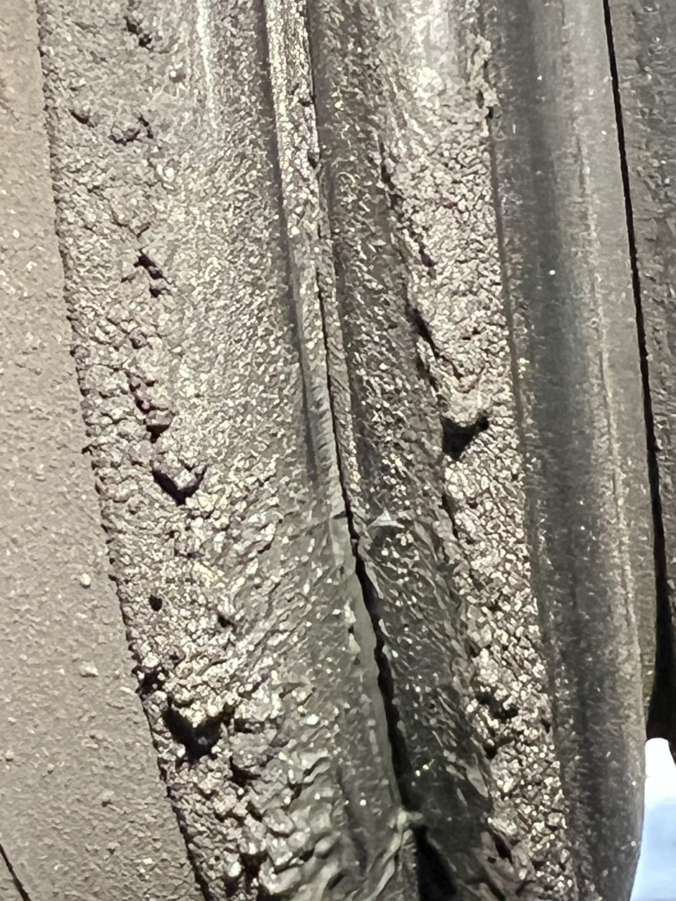

    I was under my truck yesterday doing the trans drain/fill and noticed my passenger side CV boot to the wheel had a little grease on it. I cleaned and felt around for cracks or damage but felt nothing. Anyone else have this happen ?
    truck has 103k.. is it normal for boots to leak around this mileage ? Driver side is fine. Just would like to remedy this before it gets worse.

    Yep…..that’s a leaking boot

    Yes totally common especially if lifted or you off road at all including fire roads, cvs are generally a weak point. Passenger side usually goes first

    Not sure if that's a crack or just grease. If you clean it and only find a pin price you can clean it and put some silicone then leave it to dry. If you need to replace the boots its actually pretty easy to do, hardest thing is removing the axles. You will need a secured large vice, mini sledge and medium/large snap ring pliers if memory serves, also a willingness to get rather greasy.

    You have a leak. Best option is to reboot the OE CV joint with another OE boot. Don't replace it with aftermarket junk.
