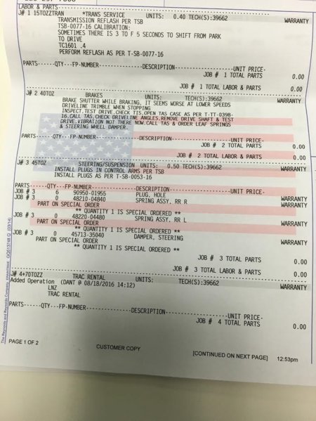

    The dealer has had my truck the last couple of days for the "rumble strip" feel when braking issue. They were in contact with Toyota on this issue. Toyota has a kit out, although on back order right now, that is supposed to address the issue. It is a leafspring kit that is supposed to change the driveshaft angle. The SA also told me he believes the angle of the axle/rear diff is also supposed to change. They could not explain in great detail because today was the first they had heard of this themselves. They said it will be a week or two before parts arrive. There is not an official TSB for this yet according to my dealer.

    The rumble strip feel is caused by the front driveshaft spinning slowly. No repair in the rear is going to change this

    Toyota seems to think so. We will see.
