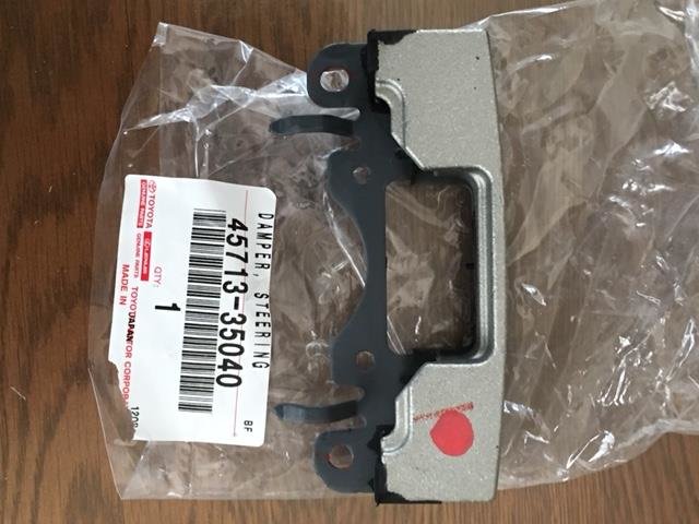

    The springs and damper are available online. Are they supposed to be the T-SB parts?
  11. Aug 22, 2016 at 1:49 PM
    #71
    goose443
    goose443 Well-Known Member
    Jun 8, 2016
    #189076
    741
    Austin
    Texas
    2016 Tacoma TRD Off Road 4x4
    What is that??
  12. Aug 22, 2016 at 1:54 PM
    #72
    Rambeaux
    Rambeaux Diäb soulé
    Oct 26, 2015
    #167793
    618
    Jerkwater, USA
    2016 Blk TRD Sport 4X4 DCSB
    Cracked W/S
    Steering damper
  13. Aug 22, 2016 at 2:15 PM
    #73
    nevadabugle
    nevadabugle Desert Rat
    Jul 25, 2014
    #134701
    3,991
    Elko, NV
    2016 DCSB TRDOR manual in quicksand
    I wonder What would this do for the vibrations felt in the 2000 rpm range through the steering wheel? Hmmm...
  14. Aug 22, 2016 at 2:15 PM
    #74
    goose443
    Jun 8, 2016
    #189076
    741
    Austin
    Texas
    Is it related to a tsb for the vibration issues?
  15. Aug 22, 2016 at 2:20 PM
    #75
    sakibomb
    sakibomb Well-Known Member
    Mar 17, 2016
    #181529
    179
    Kevin
    DFW Texas
    2016 TRDOR DCSB 6MT
    Dual Batteries Blue Sea Fuse Panel
    No TSB, 3rd gen forum will rejoice if there is a vibration TSB released.

  19. Aug 22, 2016 at 3:09 PM
    #79
    Spiker
    Spiker Well-Known Member
    Jan 9, 2016
    #174429
    85
    Don
    2016 Tacoma OffRoad Double Cab Inferno
    Bummer that the extra weight in the back myth doesn't help your ride like it does mine.....
  20. Aug 22, 2016 at 4:40 PM
    #80
    bulldog
    bulldog Well-Known Member
    Nov 8, 2015
    #169066
    2,007
    SW MO
    2023 Pro
    Umm…it’s a Pro Retired 4/29/2023 Dobinsons MRR Dobinsons UCA Dobinsons C59-314 Front Springs Dobinsons I59-110 Rear Springs 4.88 Yukon Gears CMC MobTown Sliders Line-Xed RCI Aluminum Skid BAMF Recessed Grille WARFAB Rear tube bumper SSO Full Plate Hybrid (sitting in the garage still) TTD Carbon Fiber Steering Wheel Clazzio Dark Gray Seat Covers 35% Tint Vinyl Tailgate Letters Undercover Elite Tonneau Apex Stealth Cali LED 31.5" w/upgrade OPT 7 harness and MicTuning Switch V5 Gemtech Homelink 265/75 16 Mickey Thompson Baja Boss A/T Volk Gloss Black 16” 17' Pro Rigid Fog Lights 17' Pro Tail Lights Complete sound proofing
    There was a fellow member that had his springs replaced and an angled shim was installed, w/a steering damper. This fixed his problem and was documented. When I approached Toyota with this info and documentation, they said it was an unauthorized repair because it only covered up to 2015 models and would not attempt this repair, mainly because they won't be reimbursed for anything.
    However, I hear there are new springs that have been designed to correct the departure angle, but it'll be around October till anything is available from production to allow the model year 17's to catch up since they are supposedly being equipped with these 'new springs'. This is all second hand, but I have faith in what I've been told.
