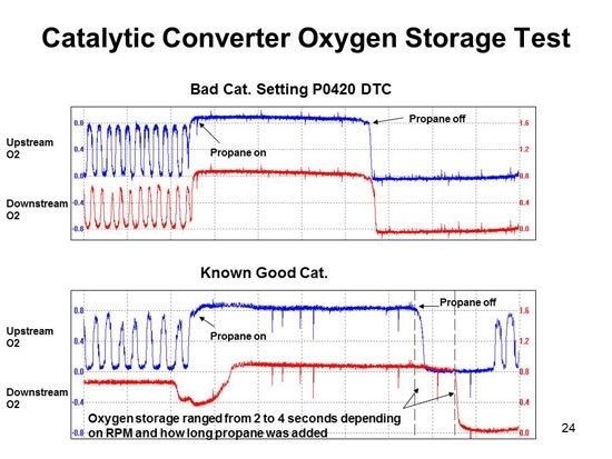

    Basically you need an educated mechanic to test the cats. It's very unlikely electrical.
    There's two ways to test it.
    1: Sniffer/exhaust meter.
    2: Watch o2 sensor voltages and trigger a fuel trim change.
    So you watch the upstream sensor before the cat, then trigger a big change, like a vacuum leak. Then watch the downstream o2 sensor after the cat to see how long it takes to react. A bad cat the downstream will virtually mimic the upstream. A good cat will have a 1 second or more delay.
    Most bad cat's you can smell, it will smell "rich" or like unburnt fuel and stinky like an old car.
    Toyota advises lately to replace the upstream A/F sensor prior to changing the cat, but I'm not sold. If there's no exhaust leaks, and the sensors are reading, its the cat. There's probably 30 codes for the o2/af sensors so its testing them all the time.
    Cat's are mechanical/chemical, they are simply monitored, but not controlled electronically.
    To me it sounds like the cats are pooched but I'd have them tested by someone that won't sell you snake oil.
