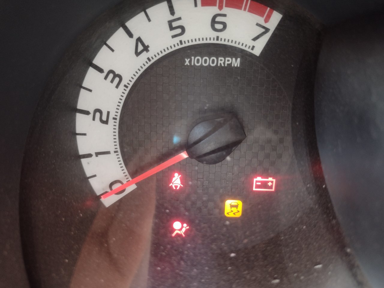

    So a little while ago I posted a thread about an intermittent crank/no start issue with my 2013 base model access cab. While that problem still persists, it's less common since it's been colder lately.
    I've noticed if I drive to work on a cold morning, then try to start my truck in the afternoon if it's significantly warmer out, it takes some finagling to get the truck to start. For this issue, I've been told to look into the crankshaft position sensor. Nothing ever went wrong once the truck was running.
    Recently, however, I've run into another more worrisome issue, and I'm not sure if it's related. Every once in awhile, the tachometer and the temp gauge will both drop to zero, the airbag light will come on, and, if I'm driving, the traction control light will start flashing. The engine doesn't shut off, but the gas pedal does nothing. This will happen for about ten seconds before everything goes back to normal, and the engine will stumble a bit, like a misfire. My power steering and brakes will still work normally, but because of the gas pedal not working I have to pull over to the side of the road until the issue fixes itself.
    Now just a few weeks ago, I installed bigger tires (235/75/R15 over stock 215/70/R15) and had the shop balance them and perform an alignment for me. The airbag light/tachometer issue didn't pop up until about a week later, but I'm not fully convinced it has anything to do with that.
    My question is, can a bad/failing crankshaft position sensor cause any of these symptoms? Are there any other potential causes I should look into? Does the tachometer/temp/airbag/traction control issue sound like it could be related to the initial crank/no start issue?
    I'm not a mechanic by any means; I do my own oil changes, mount my own tires, and can use my tools as needed when I know what needs to be fixed, but diagnostics are not my strong suit. I'm pretty good with electronics but I can't see how any of the symptoms are related.
    No check engine light, no codes, no blown fuses, I'm at a loss for what might be going on. Everything runs fine the majority of the time.

    The tach and temp dropping out, airbag, and VSC light all happening at the same time would seem to me like a low voltage issue, something funky going on with the data lines, or something goofy in the cluster or PCM.
    Whether or not it's related to the intermittent no start is hard to say.

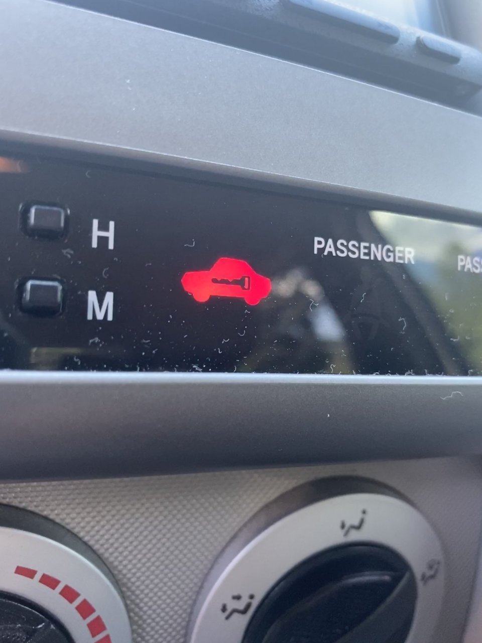

    When it doesn't start do you get a flashing security light with the key on?

    There's no check engine light and there's no codes stored in the system.

    No, mine isn't equipped with the immobilizer system.
