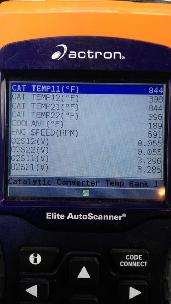

    While I was out I stopped by advance and used the scanner since you can view cat temp on them.
    I also put he o2 readings on there to compare and as u can see the voltage on sensor 11 and 21 is way to high meaning the system is dumping way to much fuel in to the motor.... hence the bad cats

    And WHY do you think it is dumping in too much fuel?
    Hmm?
    You need to quit screwing around with diagnostics, the problem is concretely identified. Now go fix it already.

    I just ordered jba LT headers and the o2 sim from urd along with new toyota a/f sensors as the aftermarket ones don't work as I have found in the past on this truck.

    How is that going to fix your catalytic converters?

    Long tube headers get rid of the upstream cats (attached to OE manifolds), O2 sims alter the signal from the o2 sensors to make the computer think it is seeing the correct parameters.
    You still need to make sure that the power is going to the o2 sensor heaters (original problem).
