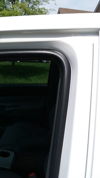

    Just an update on things the last 18 months. I quoted my first post just remind people of my original fix.
    Next phase ^^^
    That brings me to yesterday. The tube in the corners as been pretty effective over the last few weeks. But I decided to try something else to improve it even further. I placed some white electrical tape (Scotch brand) in the jam corner where the door seal corner makes contact. It runs about 8" or so either direction from the corner, with a couple of smaller pieces in the very corner to bridge the gap.
    Very hard to see it in the pic...as it's white on white. Hopefully you get the idea. I will post results in a couple of weeks.
    BTW...I still have the tubes in. So the tape is supplemental.

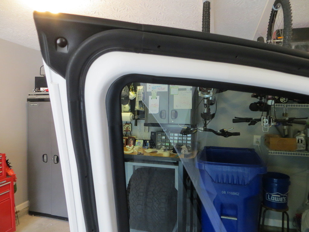

    Wait... so where do you put the tubing at?
  16. May 2, 2017 at 9:44 AM
    #196
    Aw9d
    Aw9d That one guy
    Nov 7, 2011
    #66635
    19,326
    In the door seal on the door. This isn't my pic but I used the the little holes to feed drip line into it. Lube up the drip line and be careful or the hole may rip open more. That's what I did and it helped out quite a bit.
