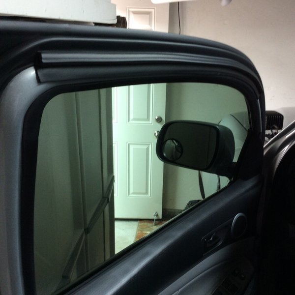

    My tailgate seal still works great for this issue. My pass door started the creak and I applied a strip on it and it worked on that door as well.

    I think it's extang. I got it on Amazon. I bought 2 rolls for my tailgate (which works awesome if you have a shell or bed cover) and tried the leftovers on the doors. Works great and blends in Nicely. I couldn't sleep at night with that hideous white tape these guys are using. The door feels more snug also. :thumbsup:

    The door is flattening out. Roll down the window and pull on the upper frame to bend it again. More weatherstripping will just flatten it even more. Don't slam the door.

    I didn't remove any weatherstripping. I just added the seal below the weatherstripping. It comes with 2 way tape already to stick on. And they come off easily and leave no residue if you need to peel and relocate it. :thumbsup:

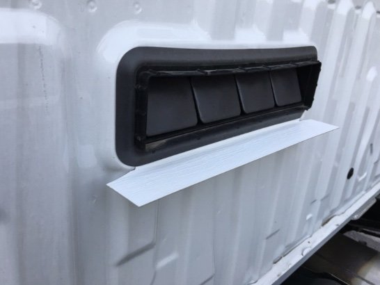

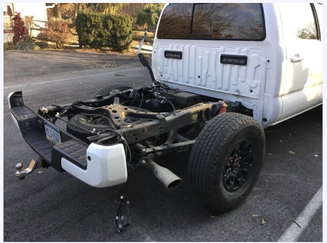

    So, I've mentioned that the drivers side door seal squeak is affected by the Recirculate function on the AC controls. Can't remember if recirculate on or off makes it go away or become less... but that's not important at the moment.
    What I did just learn is that we have "cab vents" behind the rear seat in the double cabs (and other models, I assume). The function of the vents is self explanatory. But... if the recirculate function affects the door seal squeak, it makes sense that there's also an interplay with the cab vents. The vents are located in slightly different spots on different model years.
    I stole these 3rd gen pics from another forum post... but use them here to illustrate the vents I'm referring to.
    Any thoughts???

    My door squeak was present the day I bought it new. Since then I've sealed up those cab vents when I sound deadened the truck and the sound is the same. My thoughts would be the more sealed the cab is the worse the squeak would be since pressure would build up in the cab (if the windows are up). I can hear my squeak with the window down going 20mph.
