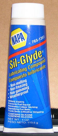

    Been awhile since I've updated this thread. My various fixes have all worked to some degree....the tubing in the corners working the best. But some noise started to creep back in from time to time even with that fix.
    In doing a bit more research it turns out that noisy door seals are actually quite common among different makes and models. I stumbled across a VW forum where several people recommend a product sold at Napa.
    I figured it couldn't hurt. I applied it to the entire outer seal around the window. I also added it to the inner seal. The noise was immediately gone and has been for months now. A couple of days after the application I added a second one just to make sure...including the valley/fold along the top of the outer seal.
    At some point I may look into the updated seals. But I'm very pleased right now and see no reason to.

    Just to add....I think it's just as important to lube the inner seal as it is the outer one.

    Just updating things. Dead silence for months now. I'd like to add, again....that I'm beginning to think the inner door seal may be more important than the outer seal. If you have the noise, try focusing on the inner seal on the door jamb.

    Sylglide did nothing but make a big mess I had to cleanup. It did 'show' me where the seal leak was though, which is the right-angle of the seal. I'm able to re-create the creaking/tapping by pushing the door seal at that corner location, at times.
    I also tried the 3/8" frost-king extruded insulation foam method - no good. At certain times I still have the tapping and creaking noise, or I can hear bass-air escaping when my stereo is set at low volume. Temperature doesn't even have influence (I'm sure temperature conditioning plays a significant factor though) over whether tapping occurs.

    Not sure how much you used. I've not really seen much of a mess at all. My seals have been so quiet for so long now, I frankly don't even think about it anymore. Maybe the thicker corners I have from the 1/4" inserted vacuum line I have puts more pressure on the door jambs, requiring less lube.
