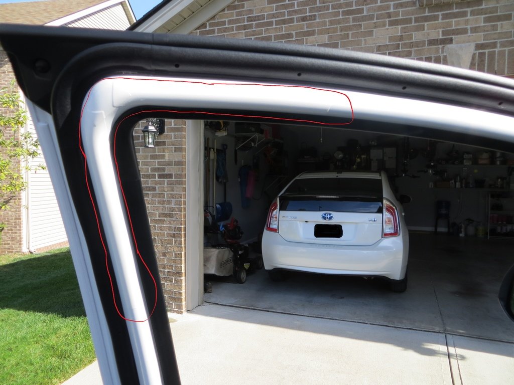

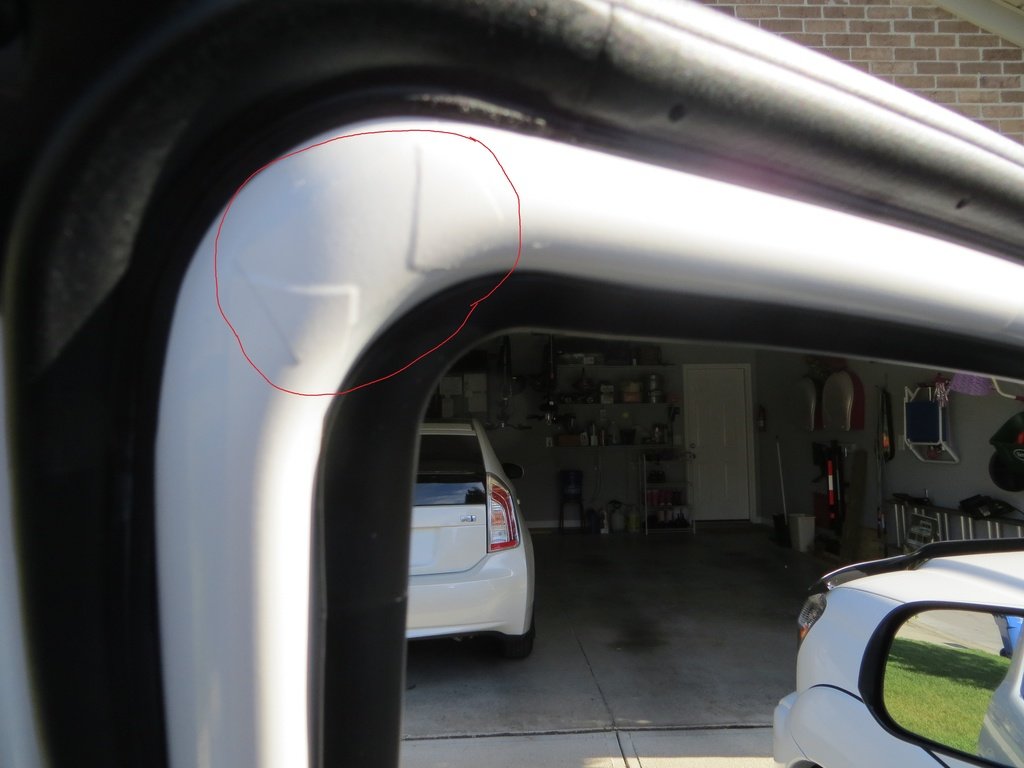

    Did that many times...plus all other manner of lubricating all of the seals....inside, outside, both sides, on top, underneath, in between....you name it. Nothing fixed it completely and/or for very long. :(
    My tape fix is still quiet. I will continue to post the results. And I'm at 2 1/2 weeks with no lube at all. That's my goal.... maintenance-free fix. :thumbsup:

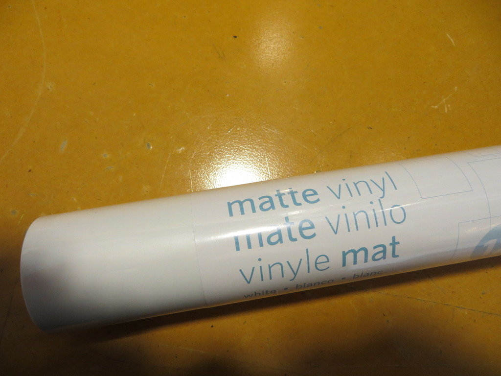

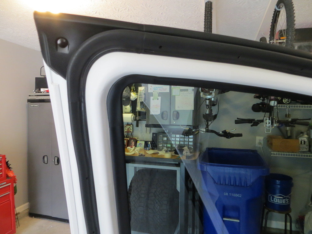

    USA
    Update: Today I bought some matte finish white vinyl at Michaels Crafts and replaced the white electrical tape I've had on for about 3 weeks now. It's a flatter finish than the tape. I will update how this is working out...though the temps are expected to warm up this week. I'll check back in about a week or so.....unless this fix does not work. Then I'll go back to the tape.
    Very hard to see unless you know it's there and are very close to it.

    Update: Went back to the tape. The matte vinyl was about 80% effective....better than doing nothing (or lubing) but not good enough for me. The tape on the other hand is more like 99% effective. As I mentioned above, I wipe out the doors and jambs after I wash the truck. So any lube that was applied a few weeks ago is long gone.
    Just in case it matters....I'm using Scotch brand vinyl electrical tape, in white.
