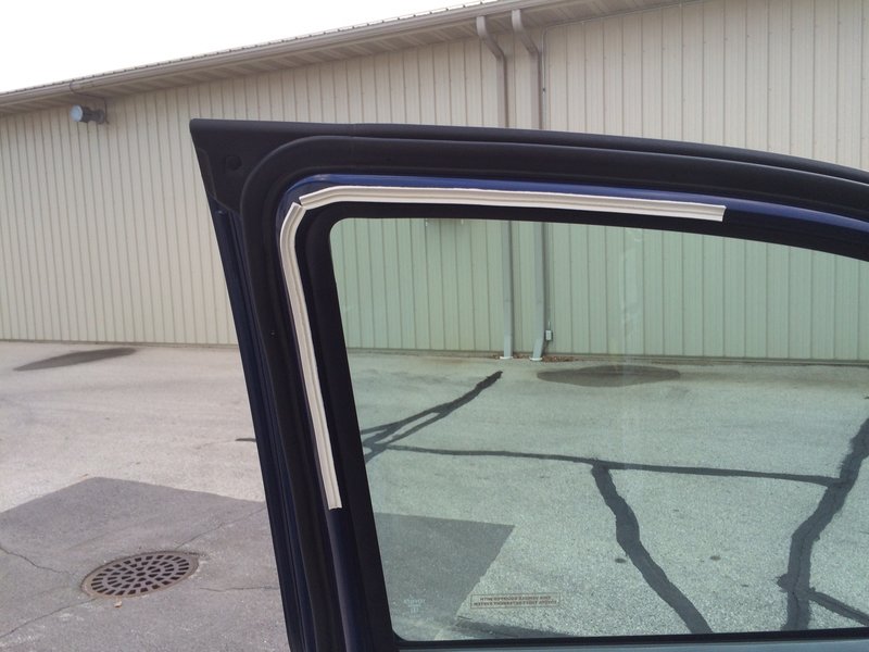

    This scotch magic tape is working well for me (not that i like the way it looks). With the door closed, I can reach up and basically "make" the noise by pressing on the cab side rubber seal where the seal is in direct contact with the metal on the door. If I move one inch further back and try to "make" the noise, but in a location where there is tape- I can not "make" the noise if I try.
    So, as someone else said- it's the interaction of those two substances that is causing the irritating sound. honestly, it's really weird that it occurs in the same spot for everyone. If it's pressure related, just by chance you'd think this would happen elsewhere in the vehicle. Why just 6 inches on the driver side? And why won't it stop when pressure is changed (for those that "stiffened" the seal)?
    Or is the stiffening working? Ha I'm getting tired if reading back through this thread. I'm sure I'm not flying solo on that one.

    You should also run some tape down the vertical part of the door frame....as well as bridging the 2 pieces with one in the corner.
