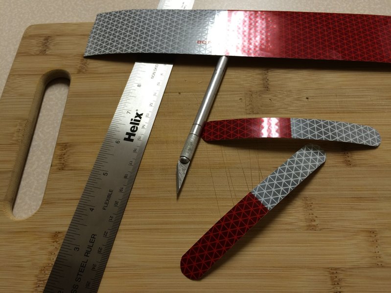

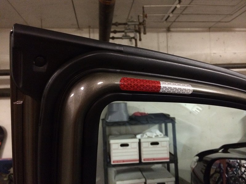

  11. Nov 20, 2015 at 1:34 PM
    #131
    NMTrailRider
    NMTrailRider Well-Known Member
    Sep 28, 2009
    #23469
    5,292
    New Mexico
    Reflector tape installed (on both sides for my OCD). I'll come back with a report after a couple days. On mine, it's just a very small area causing the problem.

  13. Nov 21, 2015 at 5:30 PM
    #133
    NMTrailRider
    Sep 28, 2009
    #23469
    5,292
    New Mexico
    Well, the squeak with the reflector tape is about 20x louder than before. Complete fail :)

  18. Nov 27, 2015 at 2:12 PM
    #138
    NMTrailRider
    Sep 28, 2009
    #23469
    5,292
    New Mexico
    For anyone doubting the source of the squeaky drivers side door seal, just stick a piece of paper up there between the cab and the door and close the door. You'll see that the noise disappears. My next sleuthing step will be using a narrow piece of paper and moving it back and forth while driving to see if I can pinpoint the exact spot or section causing the squeak. I've got it narrowed down to about 4-5 inches of the top section of seal (where I put that reflective tape in my photos above). I'll now use a 1" wide strip of paper, moving it back and forth. How I deal with that spot once identified is still in question. Maybe it's a 1/4" spot, maybe it's 3".

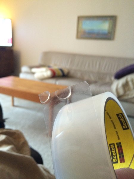

  20. Nov 29, 2015 at 1:22 PM
    #140
    NMTrailRider
    Sep 28, 2009
    #23469
    5,292
    New Mexico
    Next up. This stuff feels kinda like the 3m paint protection film (like on our rocker panels), but it's not nearly as thick. It's thicker and more durable than electrical tape and the material is closer to the 3m in feel. The adhesive isn't gummy like electrical tape, yet it's very strong. It stretches and conforms, as you can see in the photo- I stretched it on my finger and you can see that it maintains its shape. Will report back. $6 on Amazon (add-on item).
