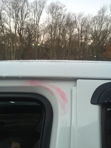

    Chap stick worked for me
    Shown in cherry flavor for application purpose

    I used 3m micropore tape. its ugly and not a permanent fix but so far so good
