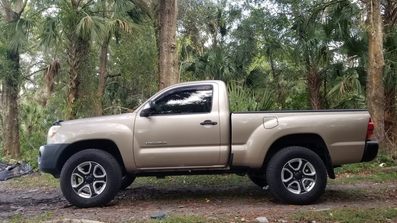

    Hey
    welcome :)
    Yes, it will fit
    But you also have to do the black box mod, (which is pretty simple n easy )
    One thing that you did not mention...
    Are you going to keep your stock gears ?
    The new diameter of the tires you are planning to run is 31.6",
    which will affect the gearing on the truck.
    I just went through this w/ mine,
    gearing makes a BIG difference on how the truck drives.
    Here is where I documented what I did on my truck
    Project Lil Taco - YouTube
    I am running 245/75/17 and the new gears I am running are 3.73 LSD
    The overal diameter from my set up to what you are planning to run is very very close.
  3. Dec 9, 2020 at 3:41 PM
