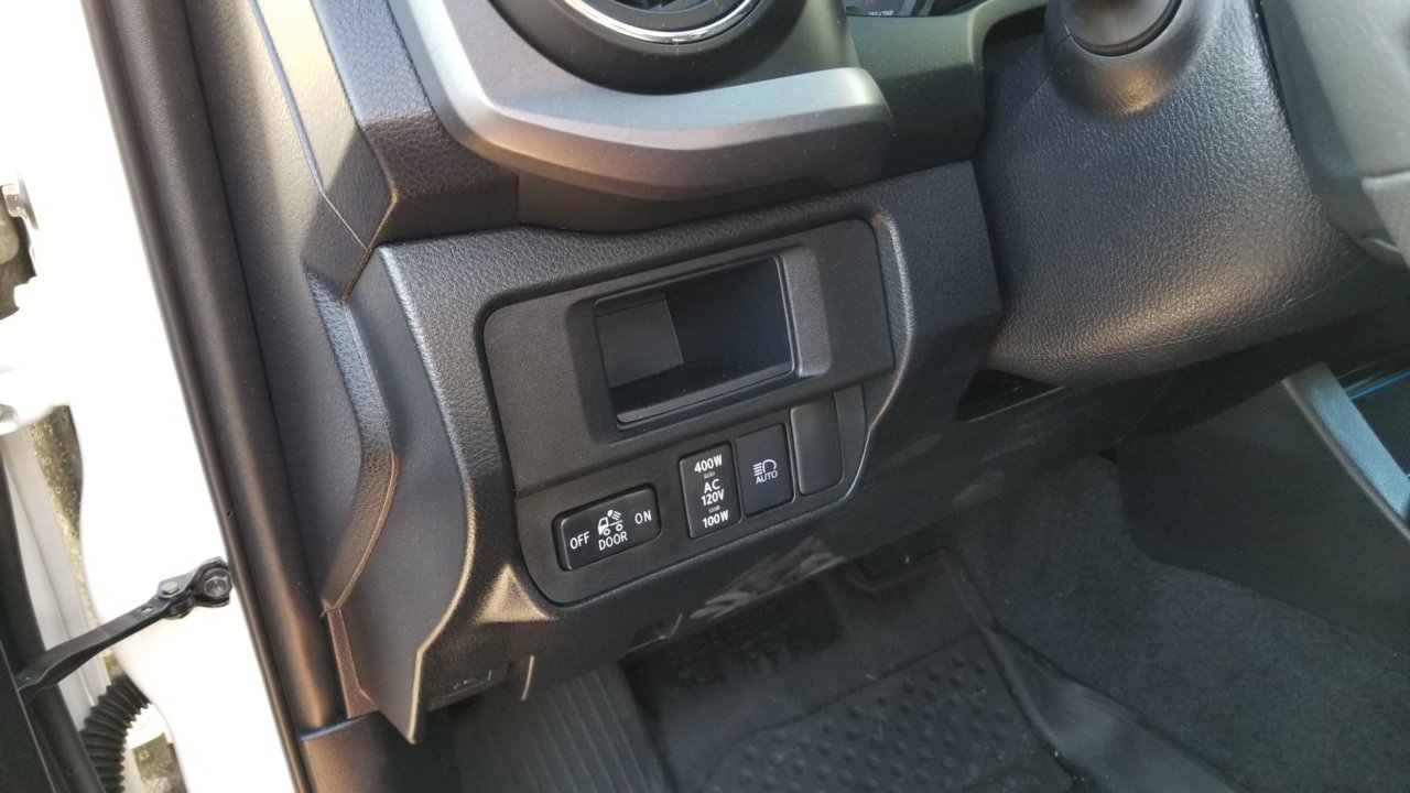

    On my Tacoma, there is a spot that a CB radio might fit. It is a small cubby above the fog light switch. I've never had a CB radio before, but I figure it might be time to get one.

    That spot is a bit too small for most cb radios. I got a hide away unit, so all I have visible is the handset.

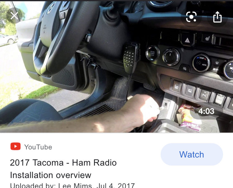

    Also, when I installed mine (thats not my picture) I put the radio in sideways, so the antenna wire was coming out one side, and the rj45 the other side. It makes it fit much better that way.
