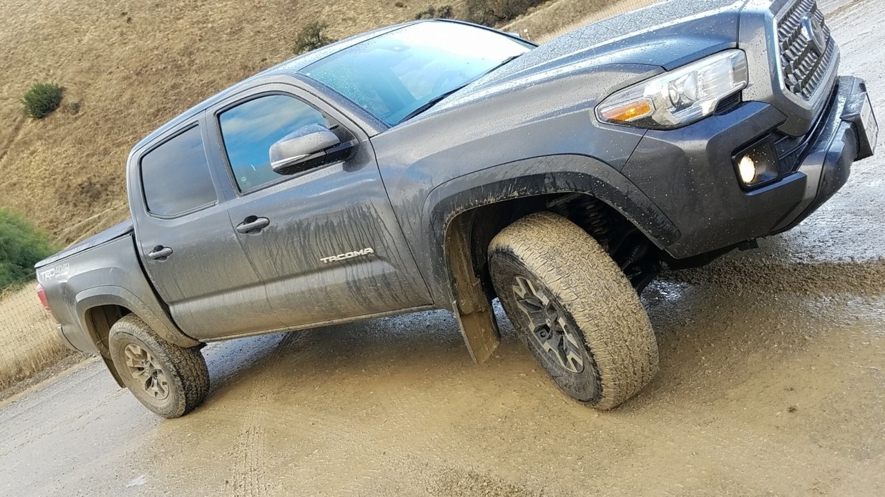

    Hello TW! I am not new to tacomas and ive owned a 2019 in the past and recently got back into it with a 21'. This weekend i was eager to do some exploring and i ended up in a situation where I already took it thru a pair of mud puddles (with only 400 miles on the clock) not by choice but since it stood in the way between me and my desired destination. It was a moderate puddle with your usual brown coloration and standing water (in the sierra nevadas) and i figured I would be fine since i got thru both puddles in 2wd but I did however sink alot into the puddle as it was quite muddy (water line came up to the frame/ halfway up the wheels). But when i got out and checked the majority of the engine bay was covered in droplets of muddy/silty water, needless to say I was pretty upset since the truck is so new. alternator, serp belt, fan assy, wiring, battery, and the eng bay walls were all covered. The underbody as well had been coated in mud.
    I did clean it the next morning with an electric powered pressure washer that i used to clean my former 2019 alot with and i was able to remove a majority of the mud from the underside and the engine bay. However some of the dried out droplets have left behind deposits of dried silt and muddy water that will not come off unless i get super close with the washer nozzle. The droplets do however come off easily with a damp rag but the water spray just doesn't do it. I plan to keep this truck for awhile and i want to know if it will cause long term effects like the alternator frying or corrosion on the frame and undercarriage. I also still have stock axle breathers so im worried those might have been compromised. I have attached some photos i took AFTER my cleaning attempt with power washer for reference.
    20201206_185503.jpg 20201206_185507.jpg 20201206_185523.jpg 20201206_185325.jpg 20201206_185331.jpg 20201206_185314.jpg
    This is about as dirty the outside got despite how muddy it was.

    I think you'll be fine. Doesn't look like that'll come off without some elbow grease.

    You should be fine. Just make sure that there is no mud build-up in the radiator fins.
    Eventually you might want to do the rear axle breather extension mod. There is a lot of info here on TW regarding that mod.

    :eek:Wipe off what you can with a damp rag.
    I wouldn’t worry about the the rest.
    Other than looking “dirty”. I don’t see any long term damage occurring.
    What little muddy water water dis get in there, abs already done what it’s going to do.
    Which isn’t much, you’d know by now.
    I understand wanting to keep it clean since it’s a new truck.
    If it were my truck, I would probably close the hood and call it good (mine is 14 years old) :eek:

    should be okay. just make sure there isnt any thick mud on important components. Also, highly recommend doing the Rear diff breather mod.

    If you wanna take your new truck swimming , there are a few mods that will help . Sealing your transfer case switch motor and your front add motor would be a good start . Use the google search feature

    You should be, at the very least, rinsing the dirt off your truck after a mud run. NO vehicle is exempt from this...none. Just go to the car wash and spray it off good after a run, preferably before it dries and you'll be fine. Obviously don't spray water into the intake and don't high pressure your electronics. Leave the engine running as you spray it too.
