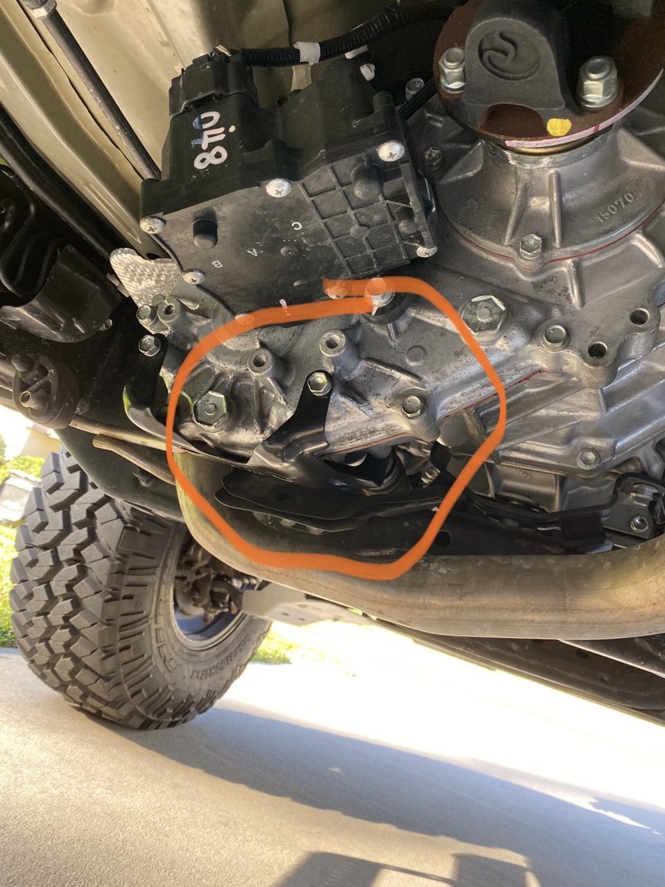

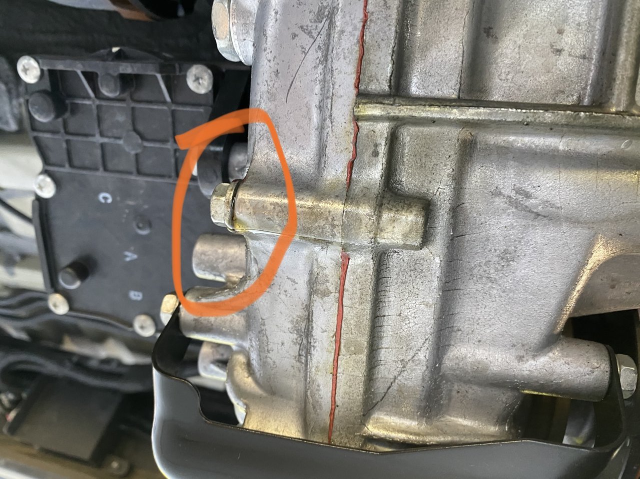

    I am at 29k miles and I happened to noticed a couple beads of oil that were about to drip underneath the truck. I am not familiar at all with underneath the truck and what many parts are what. I circled the area that the oil was (of course i forgot to take the pics before I wiped everything down). Any insight would be helpful. mainly want to know if it's serious enough to worry. I work right next to Toyota if its worth dropping it off tomorrow. thanks for any help!

    So that looks like your transfer case. What color was the oil? How thick was it? (like pretty watery or thick oil?). Have you recently put your truck into 4H/4L? If so, how did it go? Did it take longer than normal? Did you hear any funky noises?
    I think the biggest indicator of how serious it is, is to know how much it's leaking. Have you noticed oil stains on your driveway / garage?

    driveway doesn't have any stains. wondering if i noticed the first time its happening. it hasn't been in 4wd in a few months. oil was fairly loose, wasn't gunky at all, and not crazy dark. truck itself has not been making any weird noises

    I would keep on checking to see if it happens again. The guys at the dealership are going to just do the same thing
    Update the post if you get photos of the oil

    It's a '19 with 29K on the clock. The thing to do is hide thee to the dealership, and even if they won't take action because it doesn't meet the Toyota benchmark to be classified as a leak, at least get it documented.

    Just curious, what caused you to look under the truck in the first place? When was the last time you looked at the same components and didn’t notice any residue?
    That is the transfer case and the 2 larger bolts in the first pic are the drain and fill plugs (fill is upper right, drain lower left)….. at 29k miles I’d assume it never been changed since it’s not within age or mileage for a drain and fill, but the little bit of residue you showed just kind of looks like residual from someone draining and not wiping off the excess, then it collects dirt and spreads out over the case.
    I would wipe it down well and check on it again weekly until you see a change. Maybe you just ran over a greasy/oily puddle.
    I have 89k miles on my nearly 5 year old truck, swapped the transfer case fluid at 40k myself and it is as bone dry now as it every has been…. But your’s isn’t collecting around the gasket or those bolts that I can see in the picture so really hard to tell.
    I wouldn’t be overly concerned about it.

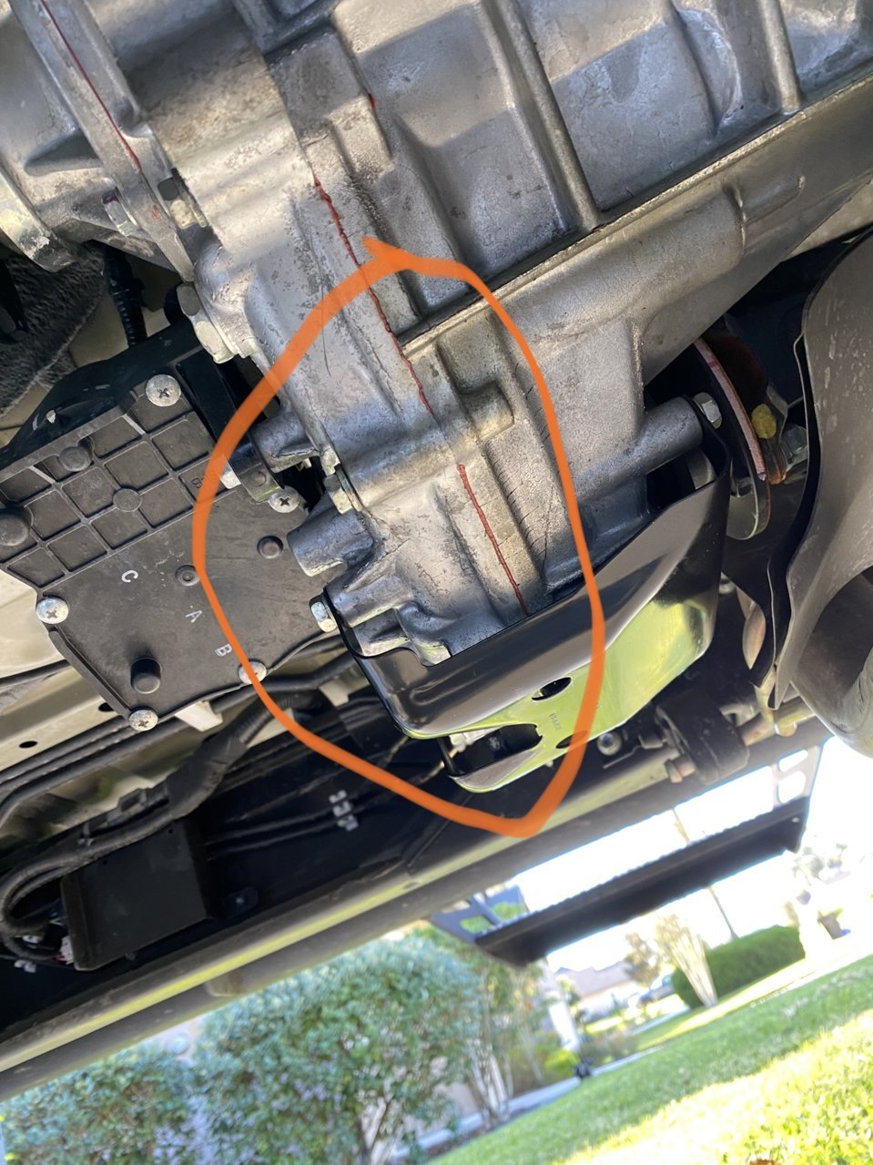

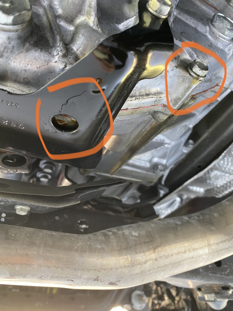

    Update. Looked under the truck this morning and got some pics showing the oil. Took it in to Toyota and they said it seemed like it was coming from the bolts the oil was and they resealed those bolts. Hopefully that was the fix.

    update. that was not the fix... went back to toyota and they worked on it again the other day. Went out yesterday, still leaking. Just dropped it off again this morning for its 3rd visit.

    Dang that sucks, but Thanks for following up, I was skeptical on the resealed bolts

    yeah i didn't think the bolts would've been it either. I think its the whole red seal around it just isn't substantial enough. I saw some people mention that if the beather gets clogged it could cause it to expand from heating up but I dont think I use it nearly enough for something like that to happen. 95% of my driving is 2wd commutes to work 10 miles one way.
