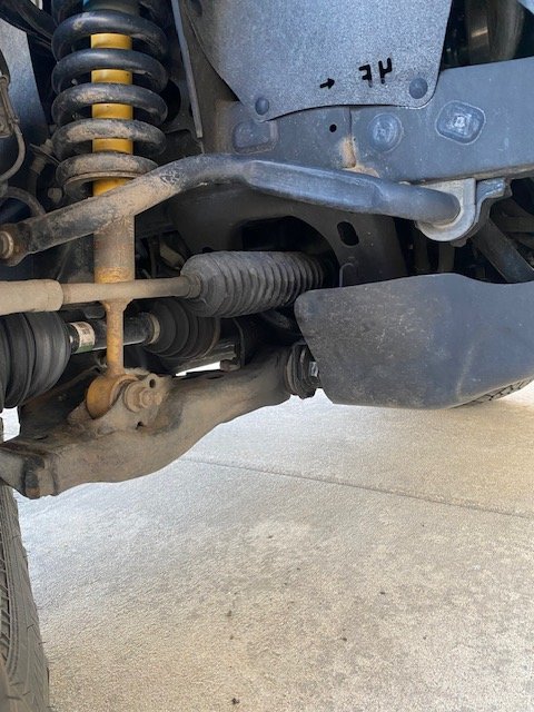

    Howdy Folks,
    New to Tacoma World, so apologies if this has already been mentioned. I have tried scrolling through old threads, but want to make sure I have this down. I have a 3rd gen, long bed tacoma - 2016.

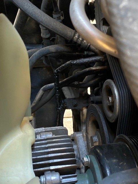

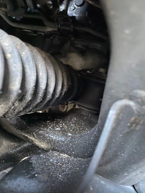

    I am pretty confident that my power steering fluid is leaking (not dripping on ground, just collecting under boot). I noticed this line is absolutely gunked up, and thought it was strange that the other lines look completely fine. I am not all that mechanically inclined, so forgive my ignorance.
    Does anyone know what this line is in my first image? Is it related to the power steering? I thought it was maybe the pressure feed tube? Maybe the power steering cooler? Any help would be much appreciated.
    Cheers

    Picture looks quite a bit like what a leaking rack seal looks like.

    Howdy everyone,
    Appreciate the help with all of the opinions/answers regarding the post. Turns out it was the timing gasket seal leaking engine oil. What a fun and unfortunate mishap that was!
