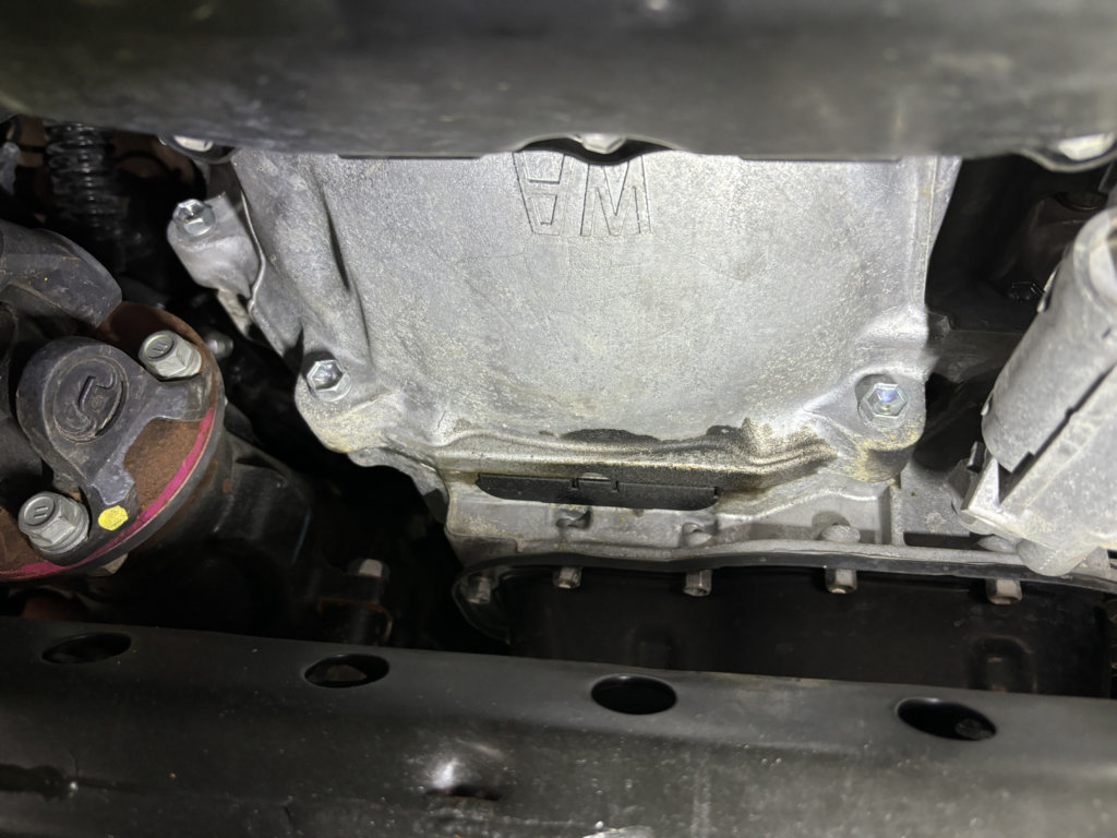

    2021 TRD OR, 29k miles, I've owned it for about two months, on-road only, and a prior lease vehicle, so I presume (dangerous, I know), it spent most time on-road before, too. All stock engine/drive components.
    Found this when swapping out the stock skid for the TRD skid. What caught my eye was a bit of oil on transfer case skid, so I poked around and found this. Doesn't look fresh, but with such low mileage, I wouldn't have expected to see it at all. I have an appointment w/the dealer (since it's still under warranty), but thought I'd toss it to the group to see if anyone had any thoughts.
    Apparent source. I poked around the area and didn't see any evidence of it having dripped down from higher up.

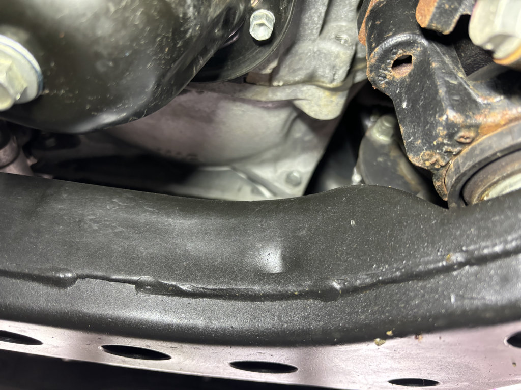

    Some light residue on the cross member immediately below it.

    Yep, looks like a rear main leak.

    Unfortunately, I agree. That’s what it looks like
    huge job, but actually fun IMO

    Worst part of that whole job, the starter and torque converter bolts.

    Update: took it to the dealership, confirmed it's a rear main seal leak. Warranty will cover it, and should get it back in 1-2 days.
