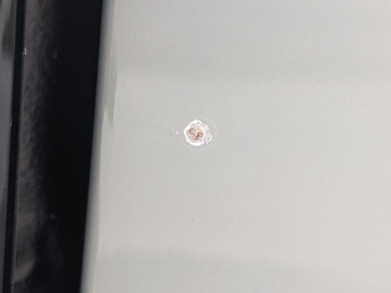

    Brand new pickup, brought it home a month ago, went to do my first real good wash and wax, and I find this on the tailgate:
    It's about the size of a BB, right next to the taillight on the left. No idea how it got there, couldn't be a rock chip in the spot it's in unless it's from a rock some kid threw at the truck. I have a suspicion its from the factory but who knows. Anyway, would appreciate a link or something to how to deal with something like this on my own rather than have someone else do it. Seems like a bit of rust cleanout and a dab of paint would get it 90% there. I don't care if something small is still visible that much, mostly concerned about the rust.

    Looks like someone shot it with a BB gun.

    That is exactly what it looks like! Can't imagine when it happened though. Its in my garage most of the time and at work 90% of the rest of the time.

    Kinda strange it's on the tailgate... Does look like a BB gun. You would never know if somebody plinked you while driving down the road.
    Bummer, but what are you gonna do? Maybe a light sanding then some touchup paint.

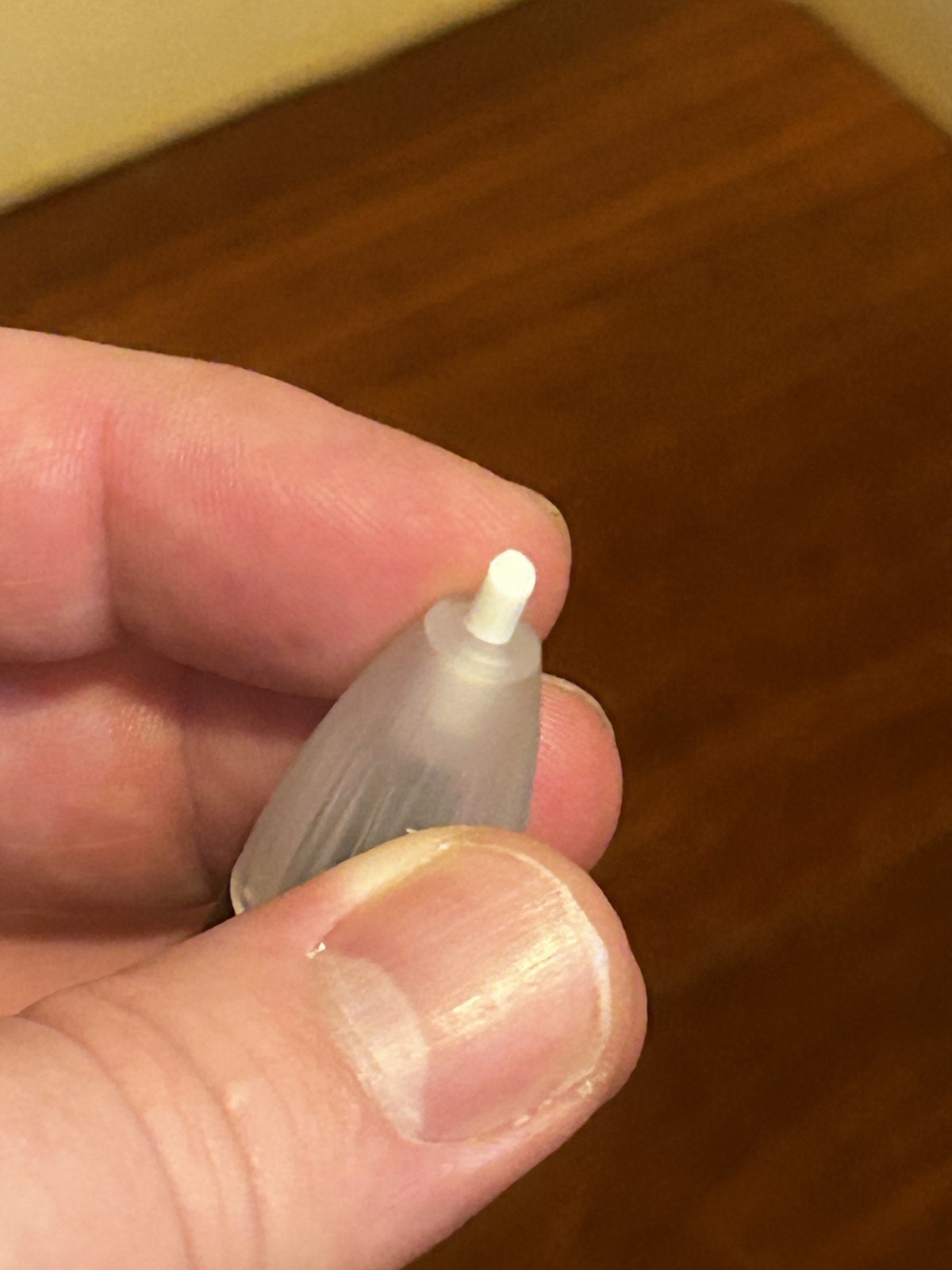

    Get a touch up pen. It'll have a sanding tip. Sand the rust off and any loose paint, then feather the edge a bit and put the paint on.

    This is a rock chip. It’s on the passenger side clamshell door. You can even tell where it scratched the primer.

    https://www.amazon.com/TOYOTA-Genui...+paint+touch+up+pen+lunar+rock,aps,141&sr=8-2
    Is this what you mean? This looks like just the applicator with paint, no sanding tip. But I could be wrong. I guess I could get this and find some small sanding tip type of thing somewhere.

  9. Nov 11, 2023 at 10:18 AM
