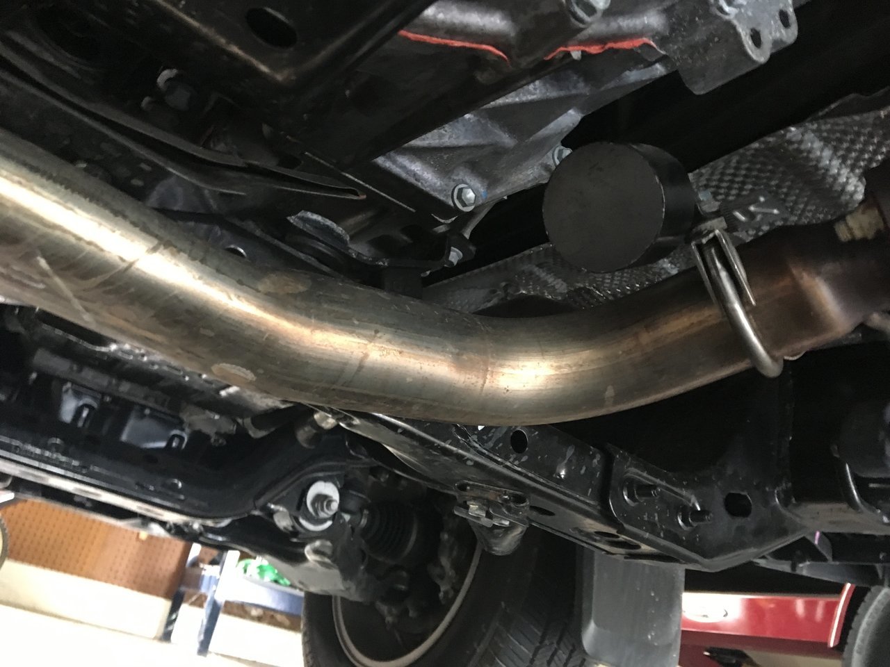

    I got this idea from the Lexus RX 350 and new Highlander forums...tried it on my Taco and the buzz in the wheel and pedal seem to be drastically reduced in the 1800 to 2300 rom range. Overall the engine seems very smooth throughout the entire rev range. Not Lexus smooth but smooth enough I wouldn't have ever noticed anything amiss.
    Pictures should be self explanatory....it is a Toyota exhaust vibration dampener and runs about $31. It has two holes in it to mount and I used one of them with a generic 2.5" muffler clamp. I guesstimated where to put it based upon a picture I saw on the new highlander forums.IMG_0845.jpgIMG_0849.jpg

    Interesting, it looks like a mass dampener. Am i correct, or is there more too it. Clever.

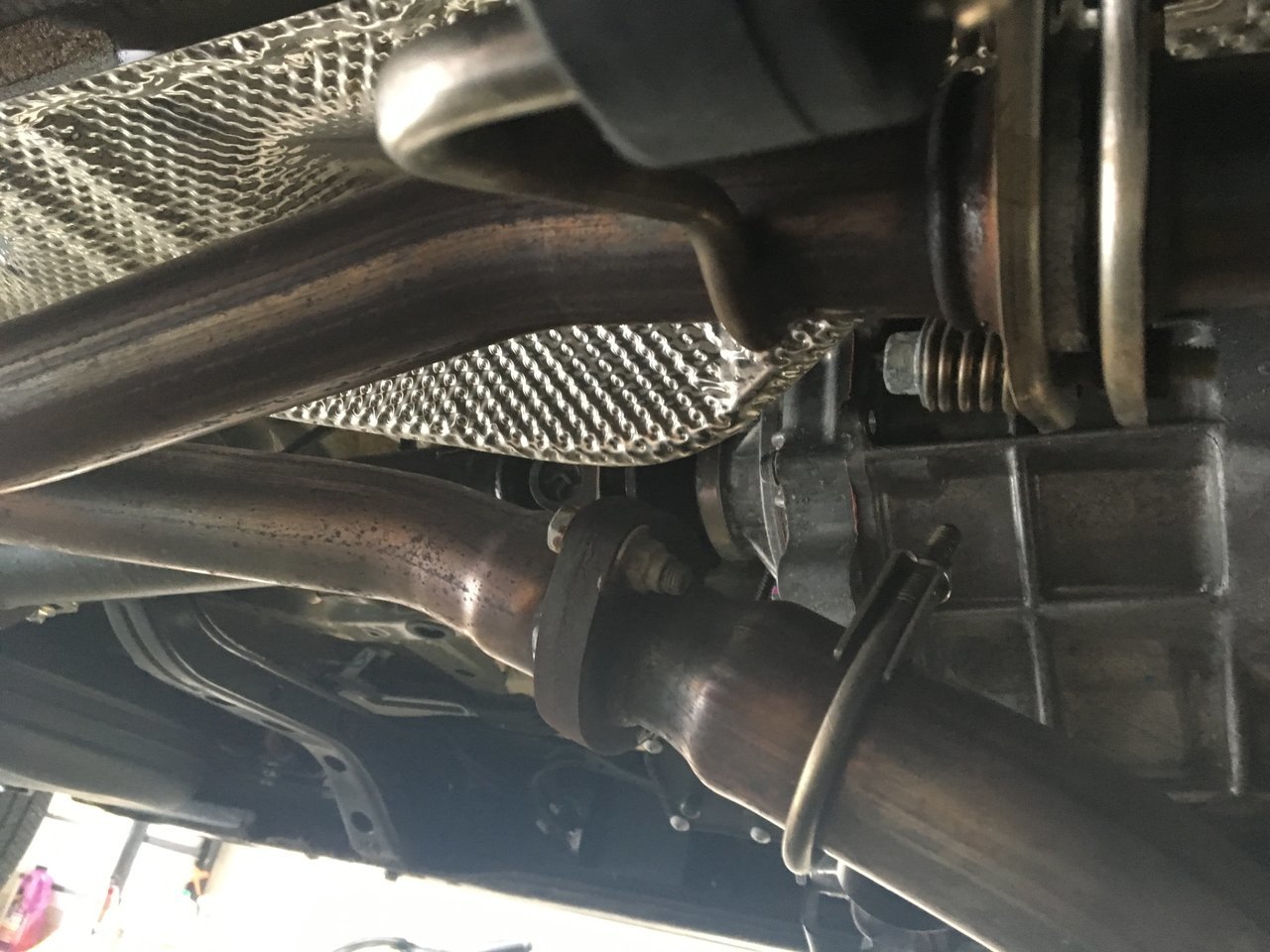

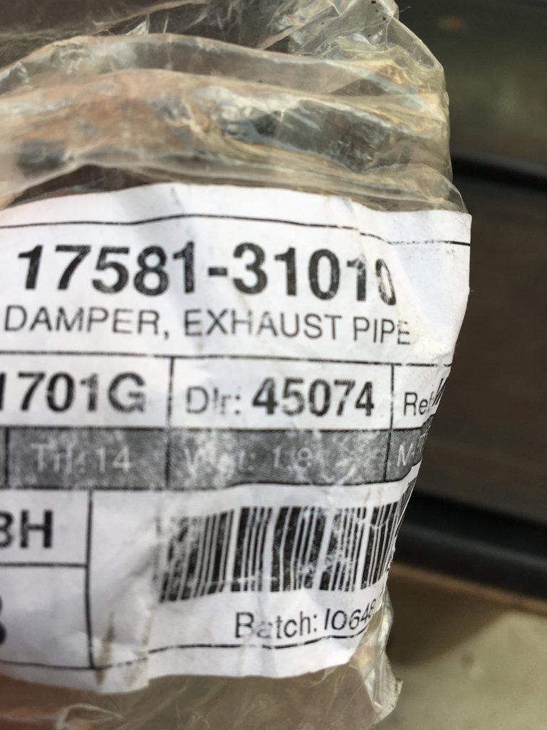

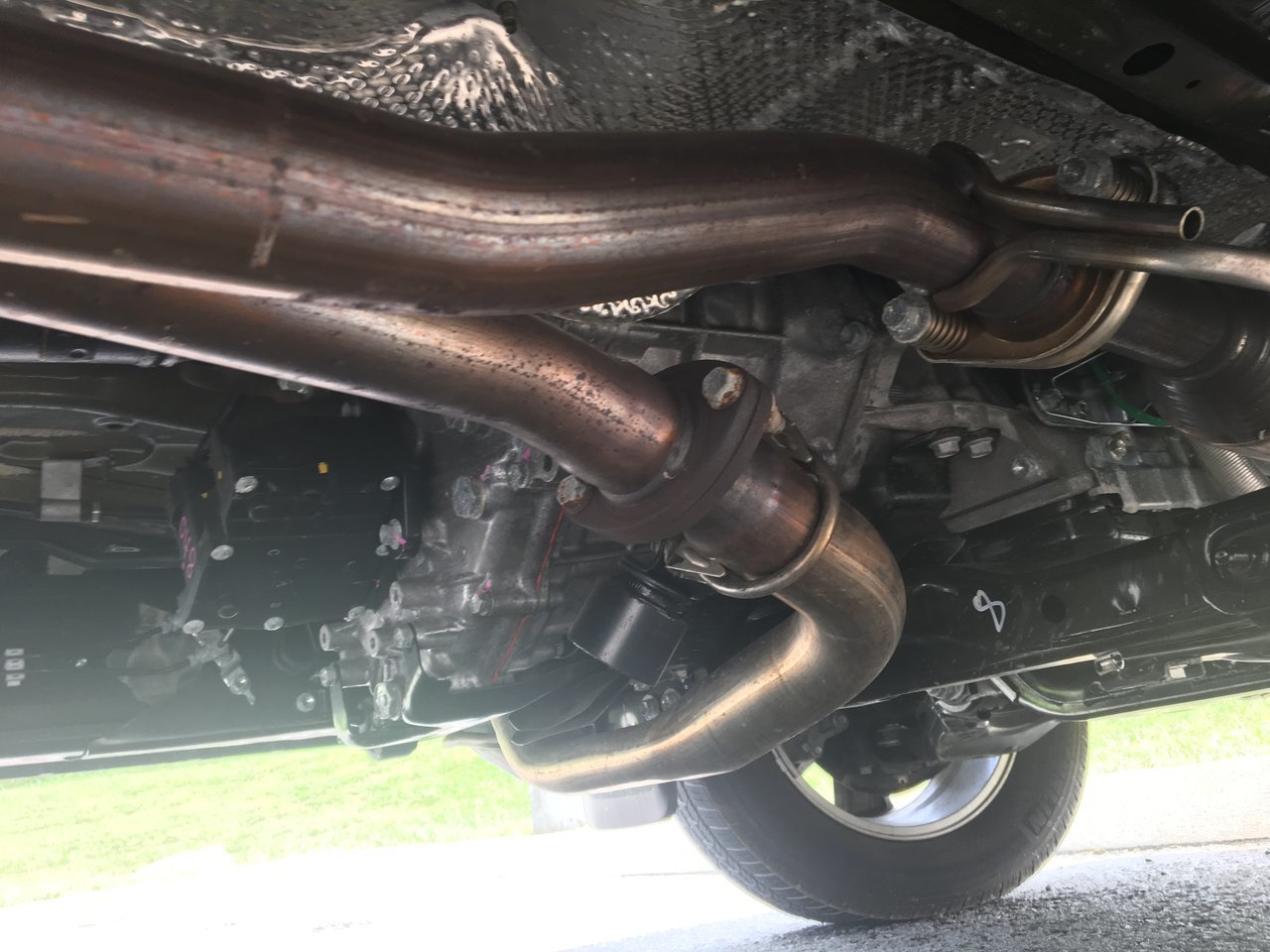

    See if these pics help. The damper feels like a heavy weight with rubber in the middle. It has two holes for mounting and I just used one of them. I first tried it closer to the muffler and it was not as effective, then moved it to where it is and am satisfied with the result. My buzzy vibe got better with the cps replacement and 91+ octane but this seemed to be the most effective. Maybe a different location will work better for some, but I thought I would try the pipe closest to the steering column.

    yep, nothing more than a mass damper.

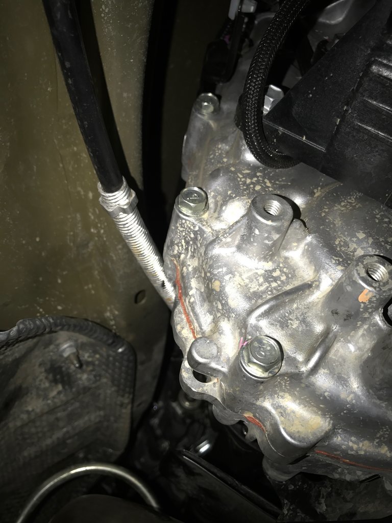

    Just look under the truck around your TC. This cable that's wrapped in metal (assume a heat shield) was rattling against my TC - kind of resting on it. I still have vibes in the steering and a little in the gas pedal, but that throbbing sort of vibe at 2k that drove me nuts my first 6-7 months of ownership was DRASTICALLY reduced by securing that cable. I just used some silicone to adhere the cable to the body so it wouldn't rattle but @splitbolt I believe had a more elegant solution that I'll probably redo it with when I have the time.

    Also how'd you get for $31? My stealership said $53!
