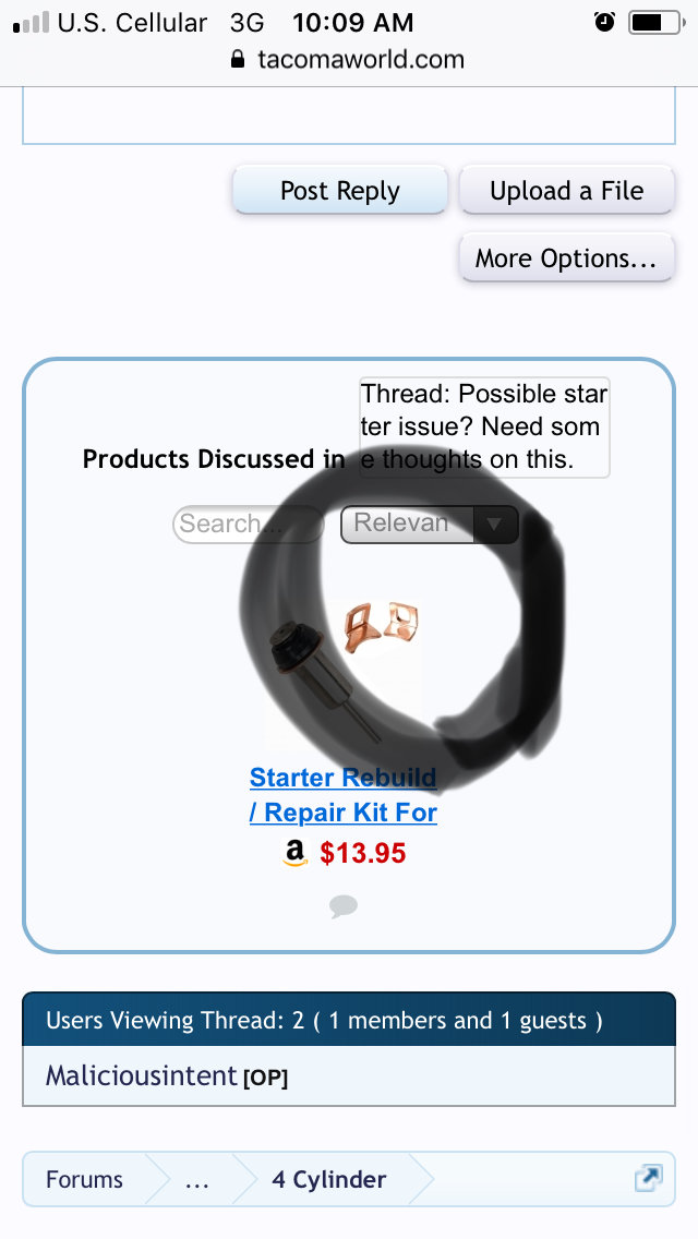

    Not sure if the newer 4 could have the same density starter as the first gens and early pickup’s, but the contacts in the solenoid and the plunger tend to burn up and cause click no start issue. The needed parts were way cheaper throug Subaru the last time i needed them. https://www.amazon.com/Starter-Rebuild-Reduction-Starters-Contacts/dp/B007FR1FT6

    The contacts are in the picture in the Amazon link I’m not sure of p/n it’s been over 5 years since I’ve dealt with this.
