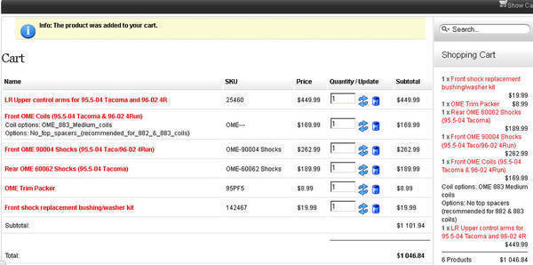

  8. Mar 22, 2012 at 3:04 PM
    AlphaEcho2k5
    AlphaEcho2k5 [OP] Well-Known Member
    Mar 2, 2011
    #52220
    1,832
    Adam
    Hurlburt Field, FL
    '02 4Runner
  9. Mar 22, 2012 at 7:15 PM

  12. Mar 23, 2012 at 10:44 PM
    AlphaEcho2k5
    Mar 2, 2011
    #52220
    1,832
    Adam
    Hurlburt Field, FL
    '02 4Runner
    No, I haven't made the purchase yet. Looking around seems like shops are out of 5100's a.t.m. I wouldn't mind going OME just unsure about which springs to go with for 2.5"-3.0" in the front, I'm thinking 3" due to a future tube bump and with my truck being v6 & DC.
