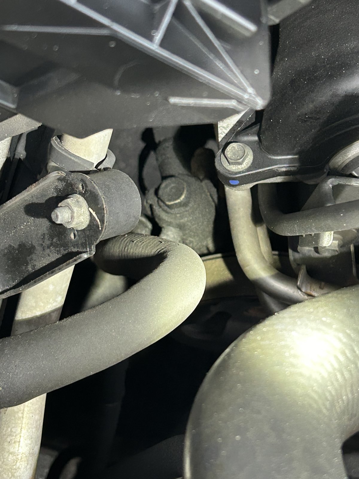

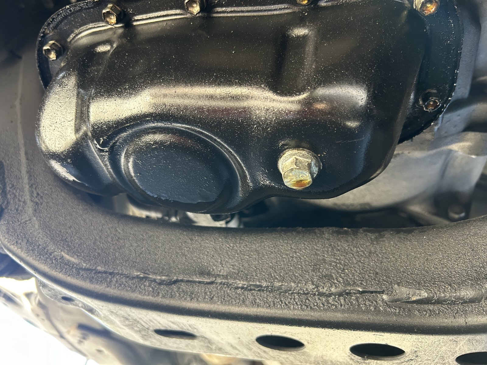

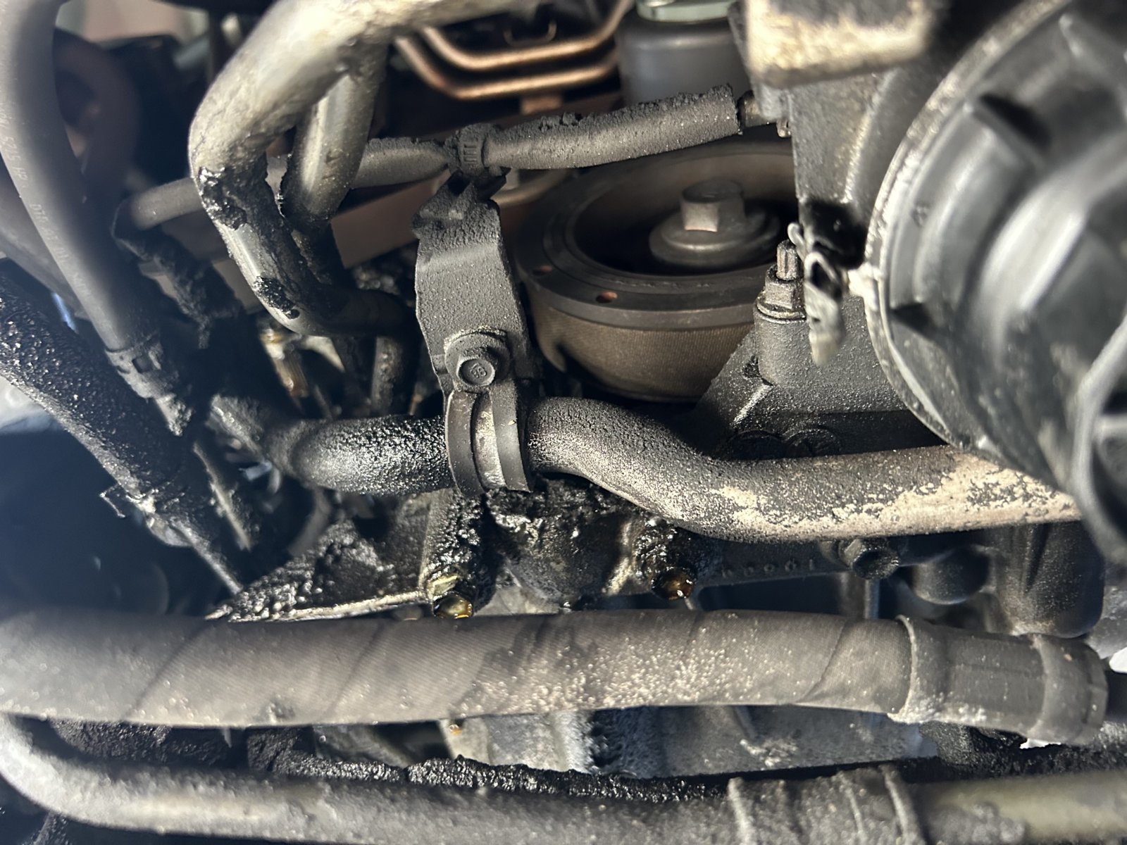

    I went to inspect myself and it’s mainly bulked up on the power steering pump. However the most fresh oil I could find is on the very bottom picture.

  18. Oct 18, 2023 at 3:54 PM

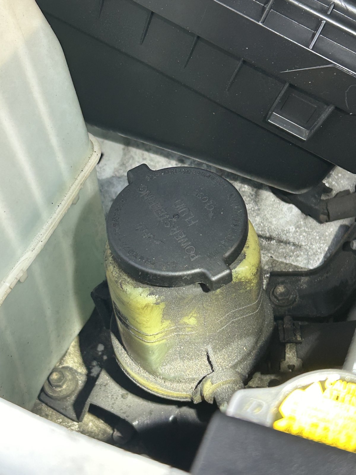

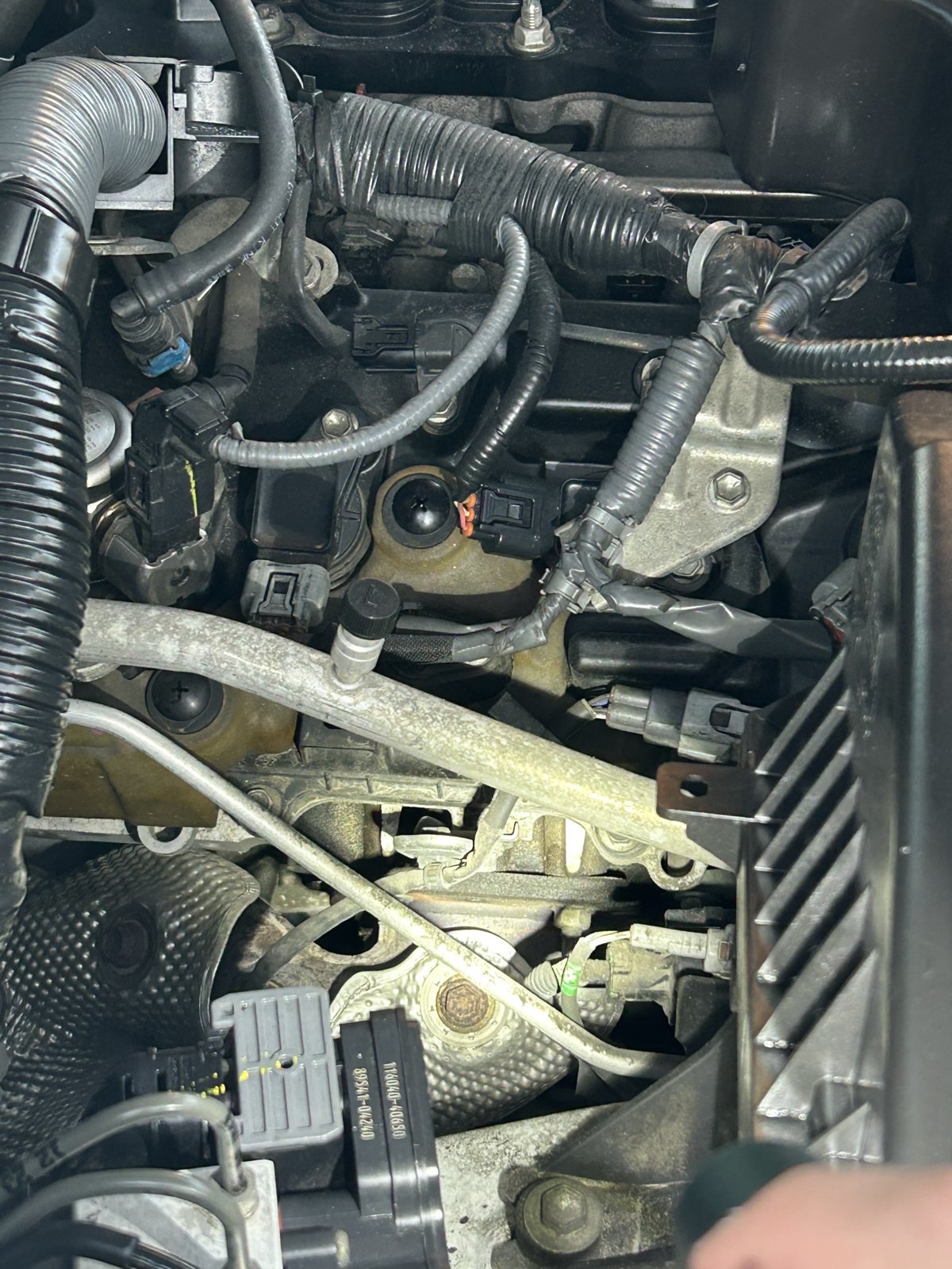

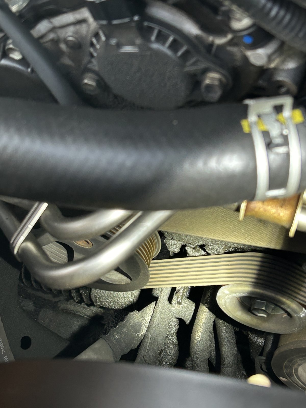

    In the first picture there is old oil right where the light is shining. Second is just the power steering fluid reservoir. Third is the ps pump from the front and the fourth is behind the ps pump. Definitely gonna go clean the oil off this weekend, or pay a mechanic to do it because it’s gonna take a lot of work to get to all of the oil and I don’t have some of the tools to do it. After that I’ll drop the super sick UV dye in the oil and see if I can’t find the leak. Not sure if I should just let a reputable mechanic find the leak at this point honestly. I get everyone has to start somewhere, but I’m very novice with car stuff (can replace serpentine belt and filters and change headlights and whatnot). Just don’t want to get in over my head and end up making more problems than I started with.
