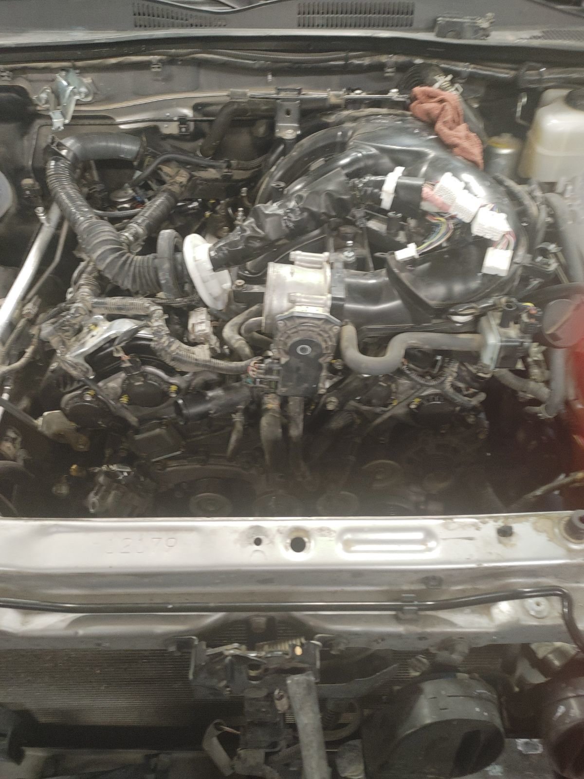

    Just got my timing cover leak fixed. It was such a small leak…like so small I didn’t notice on the dipstick over 6 months…
    Dealership got it all covered under warranty. $3k. Zero pushback.
    They had to pull the engine to fix.
    Got truck back today and everything drove fine. Warranty paid off (not first time).
    image of engine after put back in
    Canadian Caber likes this.
