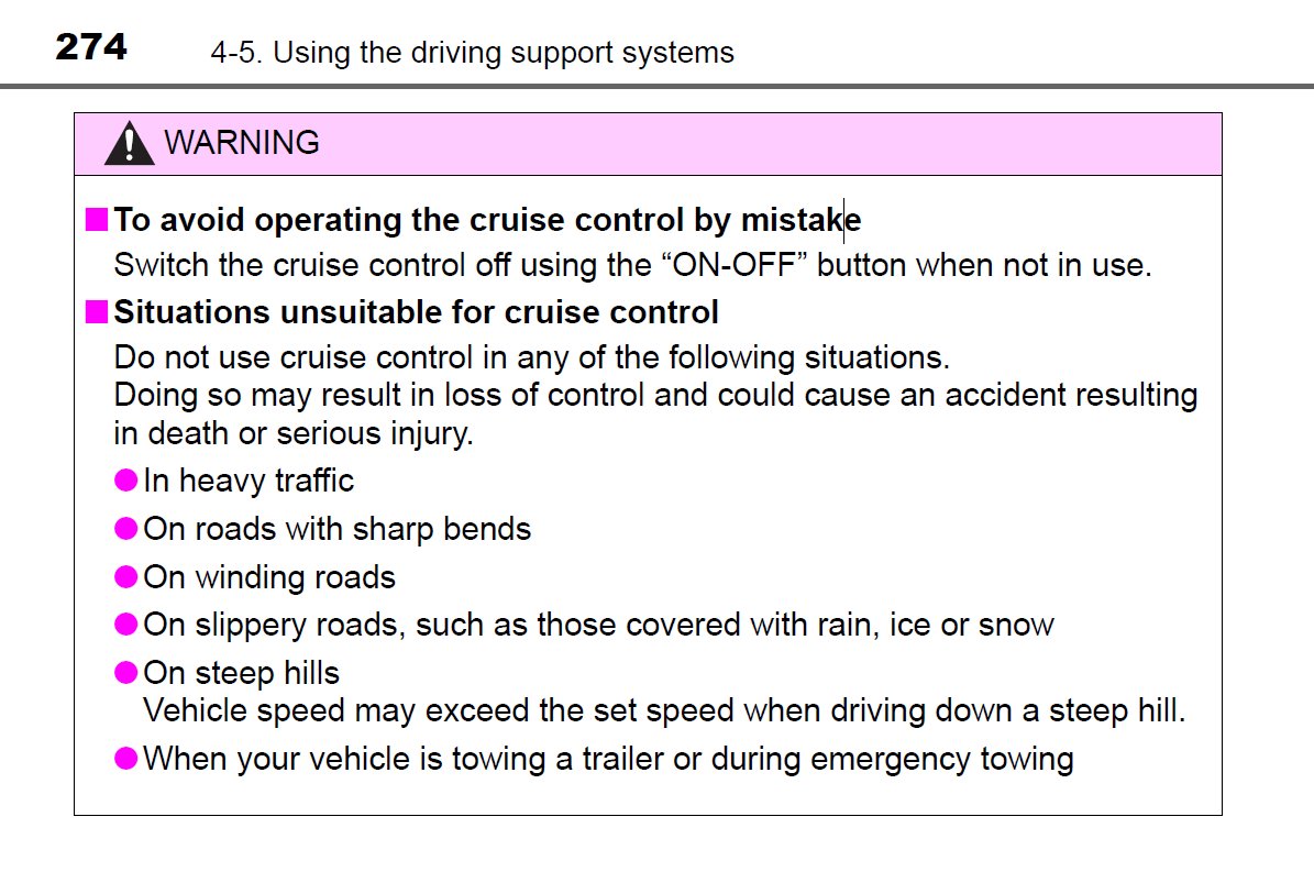

    From the manual:
    Interesting the responses. Serious question. Do you have a handicap where you can't modulate your accelerator pedal? Or is modulating the pedal too tiring?

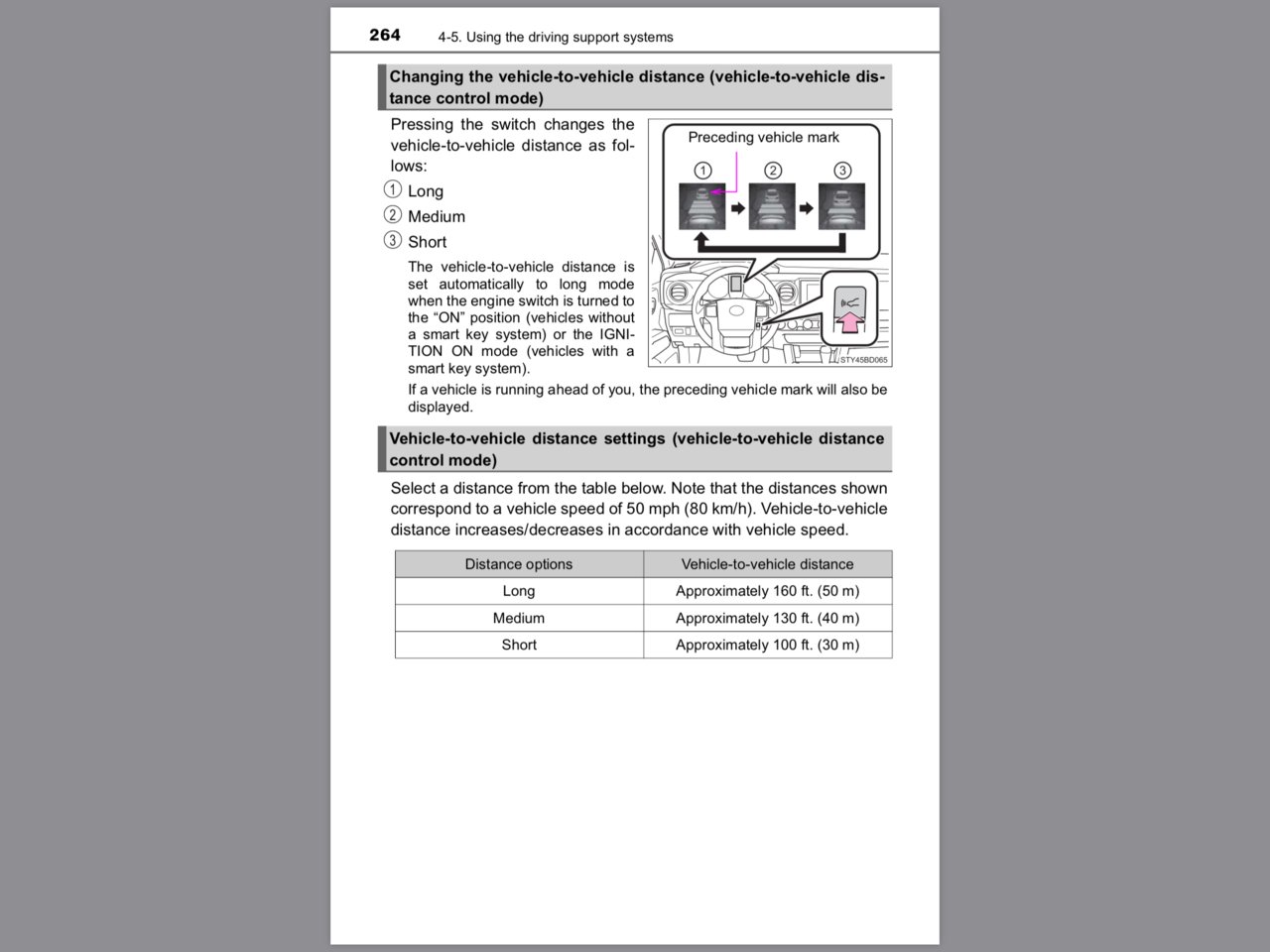

    To answer your question, no... outside of disabling the PCS radar system, the cruise control will always default to DRCC mode. Only recommendation is to set the distance to short mode and continue to use default system, or establish the habit of switching to standard CC mode.
    The over sensitivity you describe may be solved with a recalibration of the radar, suggest you bring up this issue with a service advisor on your next ToyotaCare visit.

    Thanks. I already knew about the ability to change distances of the radar, but setting to any of the distances doesn't seem to make any difference. I mean, the DRCC does work as intended, but man, it will wear out my brakes if I continue to use it as it is right now. And it is very annoying to have it put the brakes on, when I am half a block away from the stop sign, where there is one car sitting. When you are only going 25mph, I think with a half a block, I have plenty of time to brake, without the annoying DRCC doing it for me.
