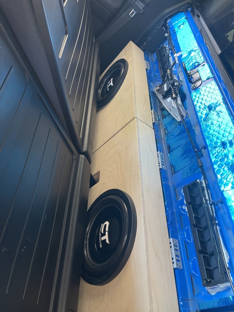

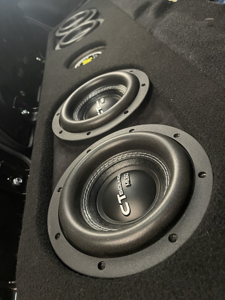

    Aug 20, 2015
    #162246
    66
    07 DCab 4x4
