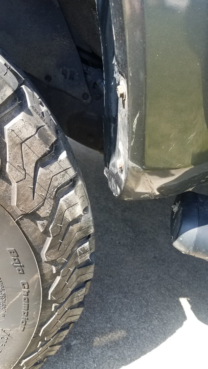

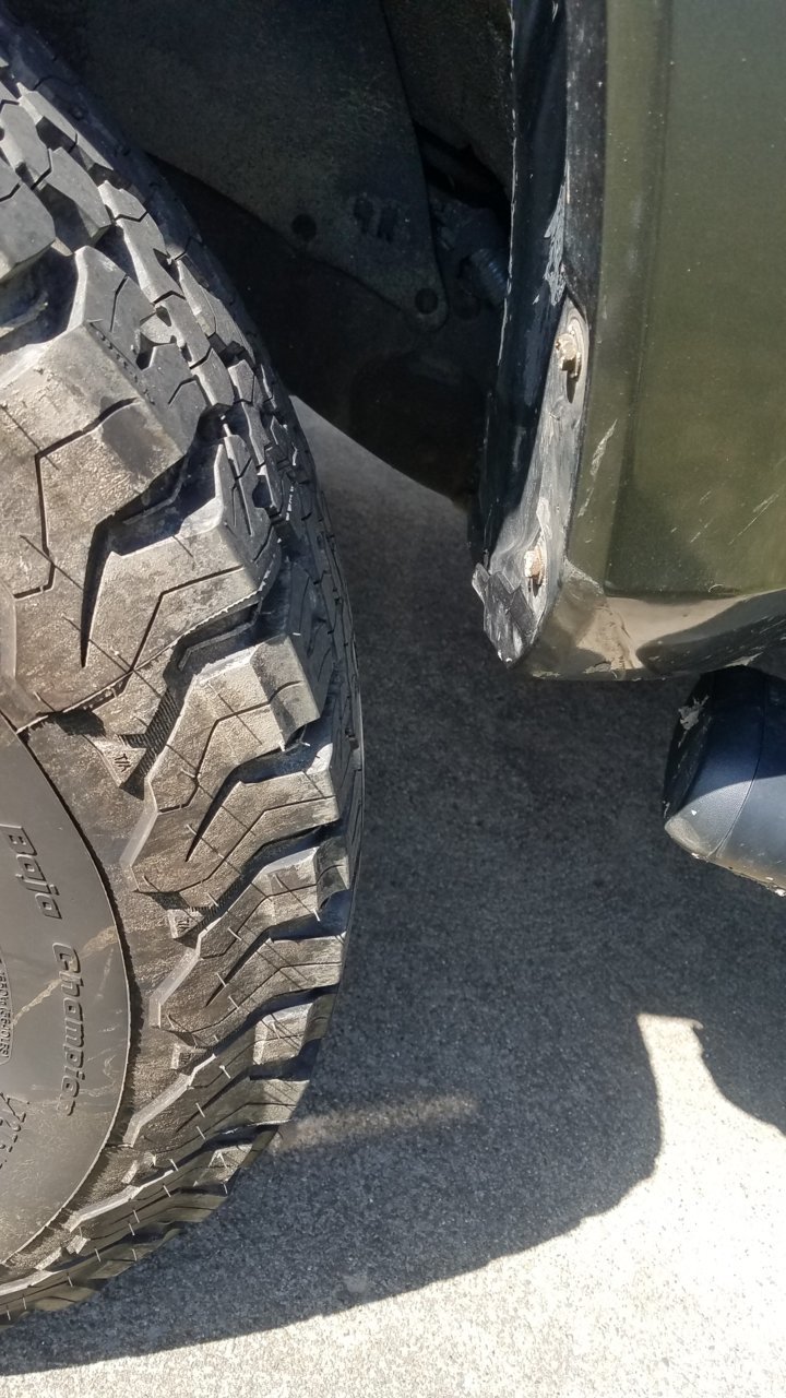

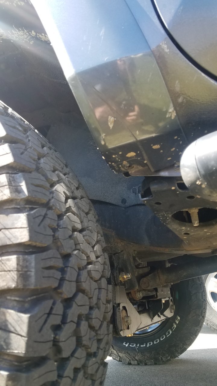

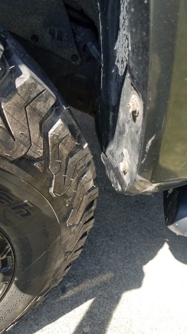

    I recently upgraded to 275/70s but the wheel offset wasn't big enough so I rubbed on my sway bar connecting rod. I then bought Spidertrax 1.25" wheel spacers and it fixed that. Now when I slightly turn the wheel and hit a bump going >5 mph, I rub on the fender, frame, and whatever else is down there (See pics). What do I need to do to fix this? Cut the fender flares, do a CMC, or anything else? You can see in the pics what actually rubs on the body. Thanks for the help. 20210321_124349.jpg 20210321_124358.jpg 20210321_124448.jpg 20210321_124516.jpg

    Start with your alignment numbers. What is your caster? Stock or aftermarket UCAs?
    Once you get that wheel as far forward as you can, start cutting plastic before you do the CMC. Sometimes taking off the mud flaps and some plastic trimming is enough.

    Not sure on the caster. I recently got a 4" lift too so my shop is going to do a realignment in 2 weeks so I will have to wait on their numbers. My UCAs are Zone Offroads, that makes sense to see if they can realign it better to rub less. Thank you.

    It looks like nothing but I'm running stock coilovers so when my IFS flexes, the body rubs. You can see a triangle of where it rubs in the pics on the bottom of the fender flare

    Don't go cutting anything until you get the alignment. Tell the shop you want the caster as high as reasonably possible, not "within spec" on their readout. Anything higher than 4* is a good aiming point, assuming your UCAs are designed to provide that. I don't know anything about those UCAs.

    It’s basically a giant spacer/bracket setup that lowers the lower control arms (uses a longer spindle and puts a giant spacer in the newly created gap between the top of the struts and upper arms. The bracket also drops the diff 4-6 inches depending on the lift. That’s what sets it apart.
    Now his cv axles are back to OEM angles but his stock travel range is now entirely 4” lower, meaning the typical rub issues aren’t reached.
    It’s possible a db lift’s specs may still allow the outer part of the fender where mud flaps mount to get hit depending on tire size, wheel offset, spacers and alignment. If his whole problem is scrub or huge offset from wheels and spacers, he can do what you mentioned and max the caster and maybe solve the problem. 275/70/17s are only 32’s and should fit with a ton of room on 4” db. Interested to see what happens
