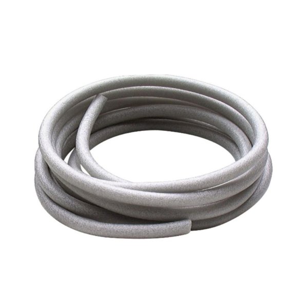

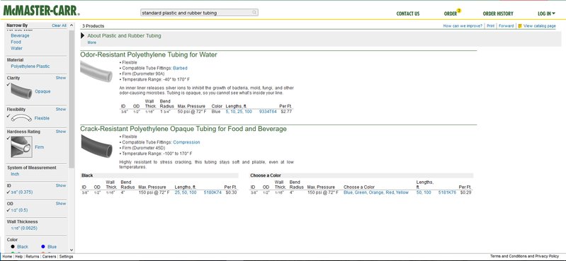

    im currently using a rubber hose with a 1/2"od 3/8" ID medium firm and its perfect. the foam may work but if it is absorbent even in the least it can get moldy.
