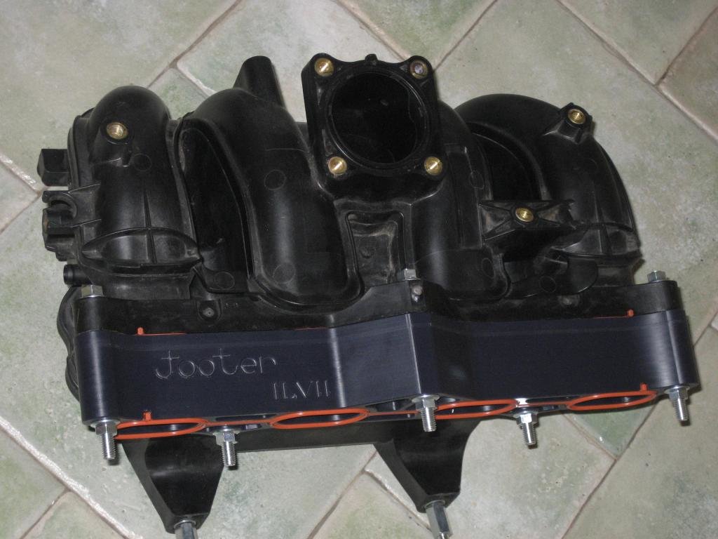

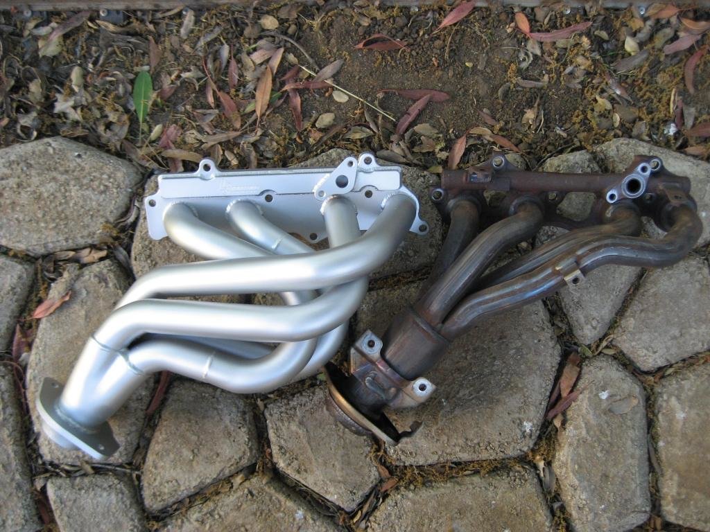

    Built for maximum low end torque, tooter II.VII intake manifold spacer, LCE long tube header, Injen long tube intake, 2,900 rpm torque peak.

    My 2.7 daily driver work truck is always loaded down with tools and material, so I run two simple bolt on mods that modestly increased the low end torque.
    A LCE long tube header...
    ...and a tooter II.VII intake manifold spacer.
    These two mods lengthen the individual exhaust tubes as well as the individual intake runners. And on the dyno, both working together lowered the torque peak from 3,800 rpm down to 2,900 rpm, while increasing the peak torque value by 20 ft lbs.
    Greg

    Generally speaking, whenever you make the passageways longer on either side of an engine, it produces more torque, and that increased torque becomes available at lower rpms.
    I had my Tacoma only 6 days before I put the long tube header on it. It's the best bang for the buck mod hands down. :thumbsup:
