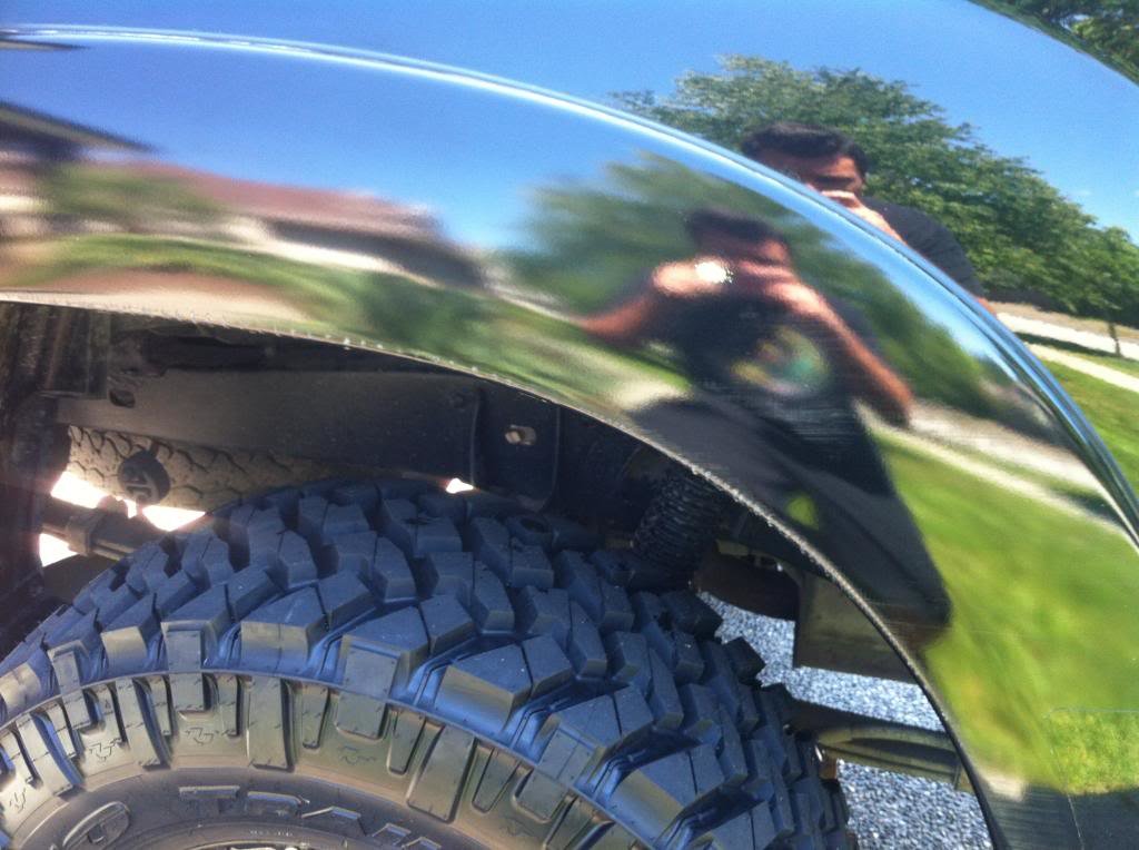

    You don't need to clay bar before polishing...
    If your going to spend the weekend detailing the truck go for it but if you just want to do a quick repair on a panel or buff up something you don't need to.
    I polish scratches off customer cars for customer service probably 5 or 6 times a day on average at work and I have never had an issue.. These are people who try to use steel wool to get rid of bird shit/tree sap (which I then have to fix :eek:) They clearly would not be clay barring their cars.
    I have never clay barred my truck because I have been lazy about it and it still shines like crazy. Even with the nasty scratches from the previous owner in the second picture and all the chips and shit from going off road.
    [​IMG] [​IMG]
