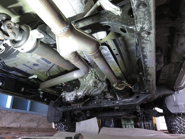

    Go to a muffler shop and re-route the exhaust crossover pipe behind the transfer case. It'll also let you get rid of the low-hanging hump below the transfer case skid.
    sAOZNJGISiAFyTYh-XrKN1-SwqZjQoC-JXhE7MOc_331f4a63eb60f6bf8f5b5917204156d6488a078a.jpg
    But yes it's possible for the thin skids to rattle like a baking pan. I'm running 1/8" thick BudBuilt "Lite" skids and it rattled a bit... until I lowered my tire pressure below 30 psi. Vibration and resonance can be weird to chase down.
